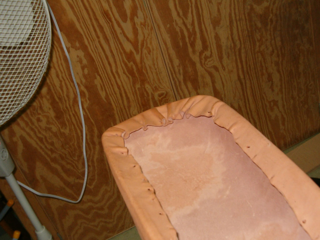

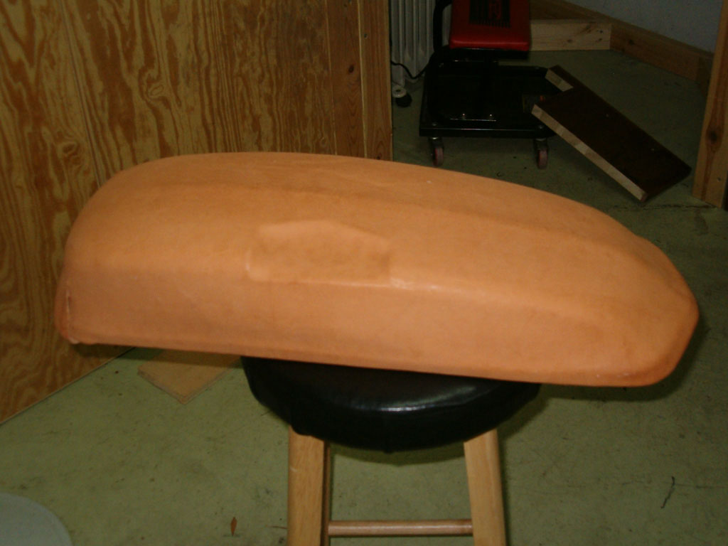

I used Banwell's idea, but kicked it up a notch. I connected an air conditioning Evacuation Vacuum to piece of #40 (heavy wall) PVC pipe, then mounted the pipe to a laminated countertop with a pinhole in the middle. I lay my object on the countertop over the pinhole then put double sided tape on the countertop around the object. I then place a piece of heavy clear plastic over the object and press it onto the tape. Now that my oject is under the plastic sheet, I turn on the vac and wait about 10 minutes. It quickly draws all of the air out and sucks the leather around your object. The nice thing about the AC Vacuum is it also removes moisture from the leather also. After about 10 minutes, turn off the vacuum, carefully remove the plastic, being careful not to shift your object and let it dry overnight. The next day, you'll have perfect shaped piece of leather that won't lose it's shape. It works on almost ANY object with awesome results. I did an old gun and a saddlebag lid from my motorcycle. Here's the results ...
This was done about 7 months ago and has been sitting on a shelf in my shop and still has NOT lost any shape!
