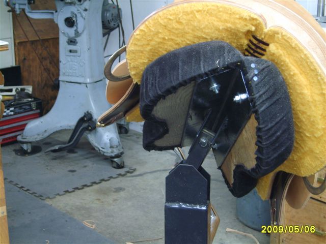

Bob Posted May 7, 2009 Report Posted May 7, 2009 Here's a couple pics of a saddle stand in our shop. Quote Bob Goudreault www.kamloopssaddlery.com
Members nobearsyet Posted May 7, 2009 Members Report Posted May 7, 2009 Did you guys build that yourself or did you buy it from somebody? Can that swivel/tilt thingy ma bob be obtained easily? Quote I really need to learn what I'm doing, then maybe I won't make too many more mistakes. But then again people have always told me I am over ambitious.

Members CLH Posted November 19, 2009 Members Report Posted November 19, 2009 Here's a couple pics of a saddle stand in our shop. Hello Bob, Who built your saddle stand and what did it cost? Thanks Clint Haverty Quote
