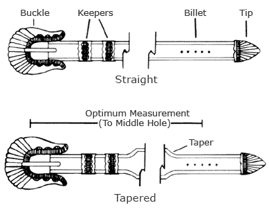

Contributing Member rdb Posted February 4, 2009 Contributing Member Report Posted February 4, 2009 Of course the best way is to have a belt to match to. I use a belt with measurements on it too (I use letters instead of sizes, that way there's no embarrassment in public settings). But if you have to ask over the phone, or without verifying, than have the customer use the method in the pic. No waist size, no buckle differences...simple measure from tip of tine to middle hole. It never fails. Two or three holes to either side of that one, and add 4.5 inches beyond the first hole to make the tip cut. If they don't have a belt, get their waist size, and add the buckle length, plus 2/3 holes and and 4.5 inches. ( I wont guarantees this one to the customer...they aren't always right about their waist.) I used to know a guy who could get the right measurement just by looking at someone...to this day I quietly do this in my mind, I'm at about 50% right now..That guy should have worked at the Carnival, he could have made a fortune... Quote Web page Facebook
