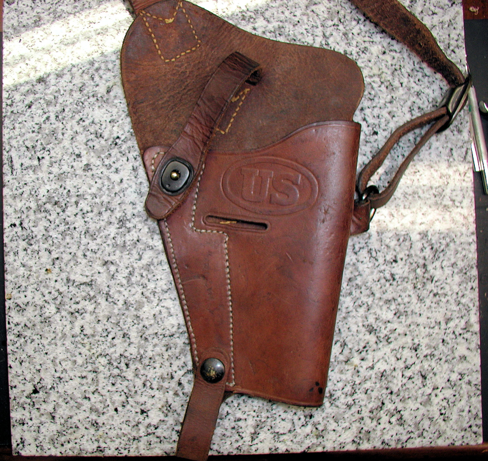

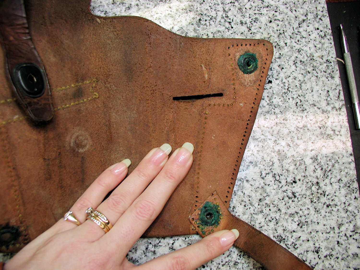

Contributing Member Crystal Posted February 24, 2009 Contributing Member Report Posted February 24, 2009 Hi All- I was given this holster to replace a snap. I had to take the stitching apart to get to the snap and found this wonderful green gunk on the backside of the snaps. What would be the best way to go about cleaning this? The holster is stamped 1944 and the leather is in fairly good shape, just a little dry. See anything wrong with giving it a good scrubbing with saddle soap, a rinse, air dry and a light coat of neatsfoot oil? Thanks for the help! Crystal Quote Black Dog Custom Leather
Members MikePatterson Posted February 24, 2009 Members Report Posted February 24, 2009 Your on the right track crystal, something like BlackRock or any good oil cond. will be fine. Quote
Members tonyc1 Posted February 24, 2009 Members Report Posted February 24, 2009 it's called Verdigris. It usually happens with brass and those snaps would be plated brass. I think vinegar will remove Verdigris, can't be sure of that, though. Tony. Quote
Contributing Member Crystal Posted February 24, 2009 Author Contributing Member Report Posted February 24, 2009 Your on the right track crystal, something like BlackRock or any good oil cond. will be fine. Thank you, Mike! it's called Verdigris. It usually happens with brass and those snaps would be plated brass. I think vinegar will remove Verdigris, can't be sure of that, though.Tony. The green is gunky and greasy feeling. I will attack it with some vinegar and see how it goes. Thanks for the help! Crystal Quote Black Dog Custom Leather
Frank Posted February 24, 2009 Report Posted February 24, 2009 Just remember one important thing about vinegar. It needs to be neutralized after using it on leather. Vinegar by itself will remove bluing from a gun in about 5-10 minutes and it's not a good thing to use on gun leather without neutralizing. Thank you, Mike!The green is gunky and greasy feeling. I will attack it with some vinegar and see how it goes. Thanks for the help! Crystal Quote Never argue with a stupid person. They'll just drag you down to their level and beat you with experience!!
Contributing Member Crystal Posted February 24, 2009 Author Contributing Member Report Posted February 24, 2009 Just remember one important thing about vinegar. It needs to be neutralized after using it on leather. Vinegar by itself will remove bluing from a gun in about 5-10 minutes and it's not a good thing to use on gun leather without neutralizing. Thanks Frank. Didn't think about that. I had read to use vinegar to get rid of mold, but don't remember seeing anything about neutralizing it afterward. I had seen where you need to neutralize the vinegroon and thought that was to stop the chemical process and help to eliminate the vinegar oder. Crystal Quote Black Dog Custom Leather
Members Hedge Posted February 24, 2009 Members Report Posted February 24, 2009 Thanks Frank. Didn't think about that. I had read to use vinegar to get rid of mold, but don't remember seeing anything about neutralizing it afterward. I had seen where you need to neutralize the vinegroon and thought that was to stop the chemical process and help to eliminate the vinegar oder.Crystal Crystal, Why not try using some baking soda in water and scrubbing the green off with a toothbrush? That should work without having the concern with the acid in the vinegar. Hedge. Quote
Contributing Member Crystal Posted February 24, 2009 Author Contributing Member Report Posted February 24, 2009 Crystal,Why not try using some baking soda in water and scrubbing the green off with a toothbrush? That should work without having the concern with the acid in the vinegar. Hedge. Thanks, Hedge. I had that suggested to me last night. I think that is what I will try instead. I just don't want to ruin someone's 65 year old holster! Crystal Quote Black Dog Custom Leather
