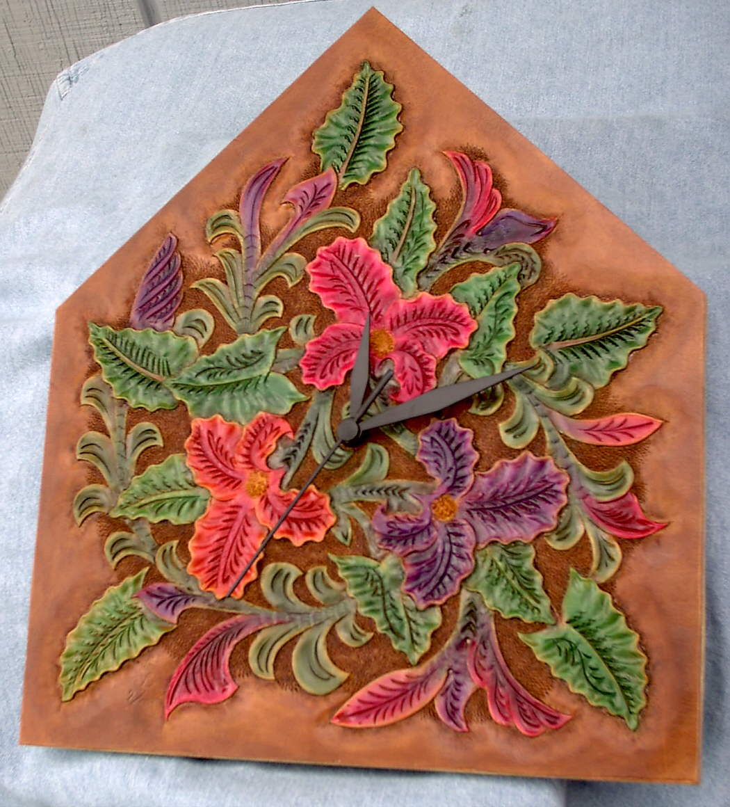

I have used powder Rit Dye mixed in Methylated Spirit to make like an alcohol-based dye that I use to wipe on dye on veg tan. . . I use the browner colors. . . I have not tried the dying method RIT suggests like if you are dying cloth. . .When I get the color I like mixing dye with the Spirit, I wipe on with a wool dawber thingy and then apply desired finish.
Hi,
Here is a project I did using mostly Rit dye's disolved in alcohol. The light russet outside, & some of the green was spirit dye, but most of it was done with different shades & strengths of Rit dye's. What do You think?? Ed
