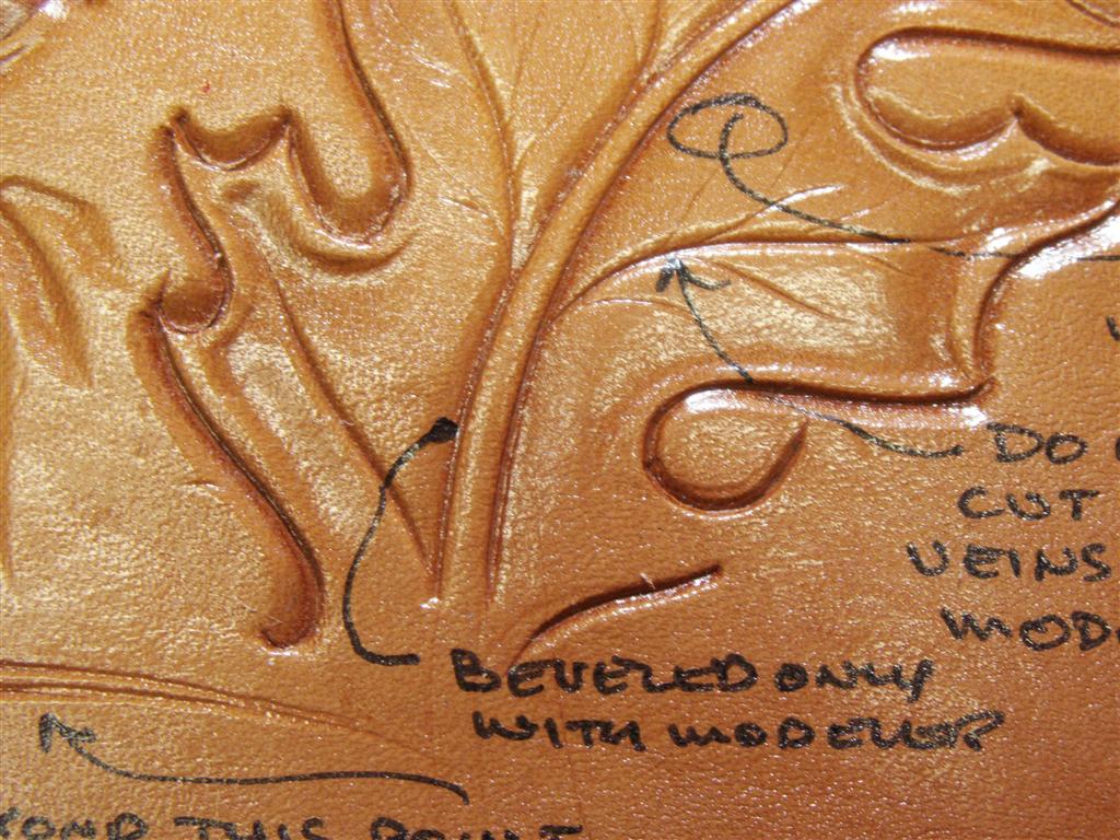

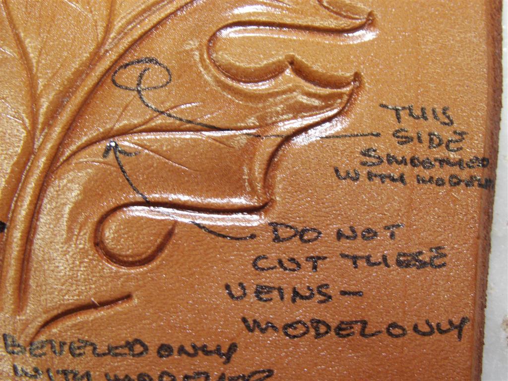

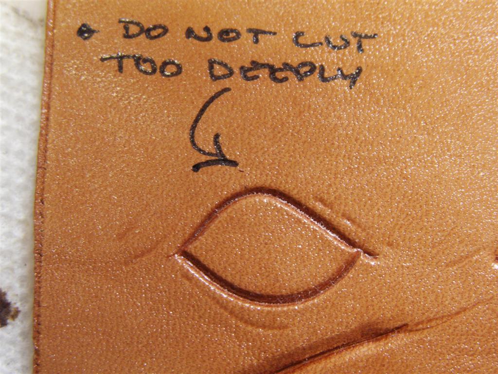

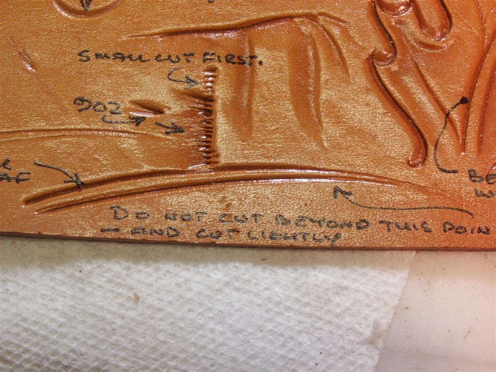

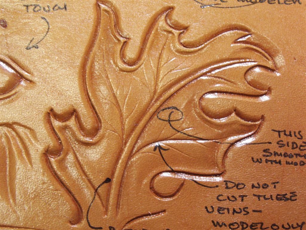

I think you're right about the modeling tool. The modeling tool is probably my most used tool. It can be used for so many different things, from cleaning up beveling, to doing actual beveling. I use it to add details, shaping, certain textures, and so much more.

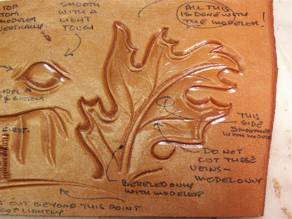

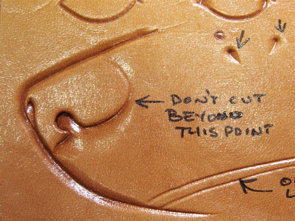

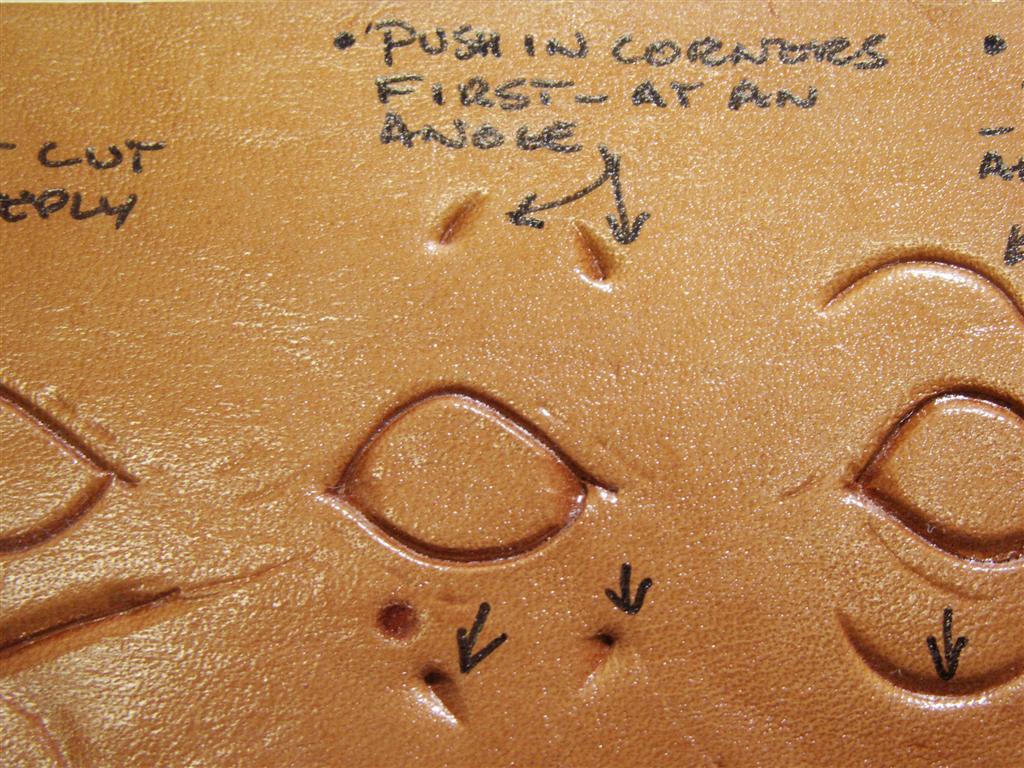

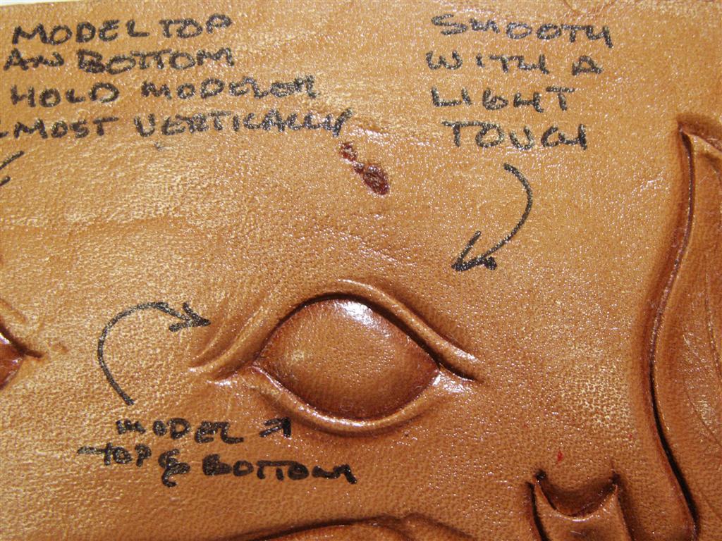

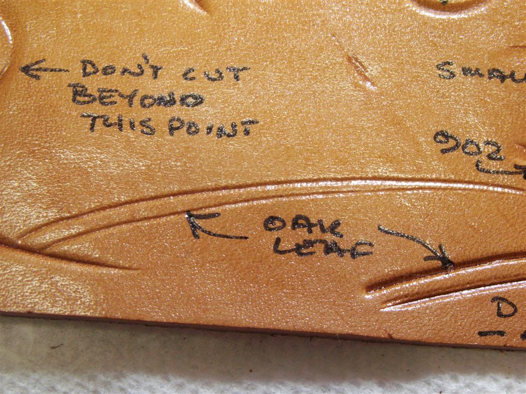

My favorite modeling tool is one that Peter Main makes and sells. When I got mine from him, he sent along a piece of leather showing me some of what he can do with a modeling tool. Here are some pictures from that scrap of leather.
modeling_tips_007__Large_.jpgmodeling_tips_008__Large_.jpgmodeling_tips_009__Large_.jpgmodeling_tips_010__Large_.jpgmodeling_tips_011__Large_.jpgmodeling_tips_012__Large_.jpgmodeling_tips_013__Large_.jpgmodeling_tips_014__Large_.jpgmodeling_tips_015__Large_.jpgmodeling_tips_016__Large_.jpgmodeling_tips_017__Large_.jpg

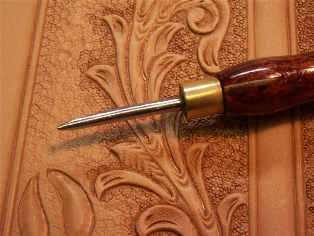

You have a photo of the tool of Peter Main? I would like to buy, where?
Thanks.

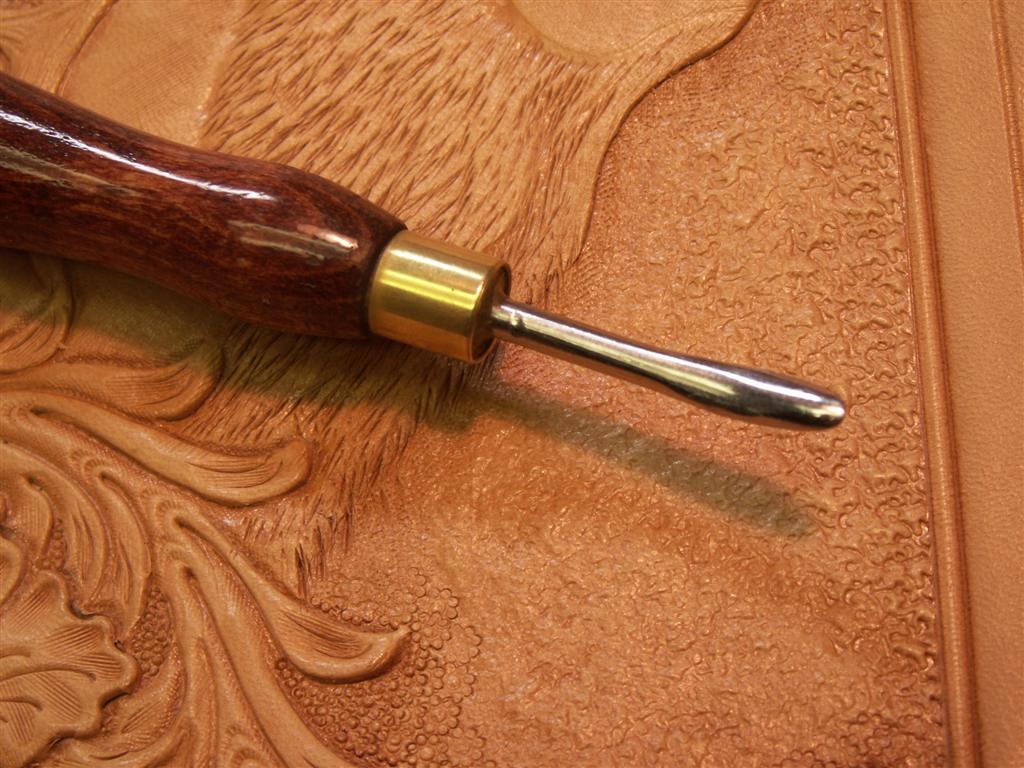

  • Contributing Member
Hi Nomad,
Here are some pictures of Peter Main's modeling tool. You can either PM Peter through the forum, or you can email him. Peter's tool has a little different shape than the Tandy tool and everyone that I know that has one really likes it.
