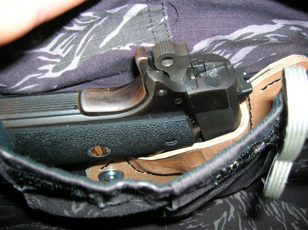

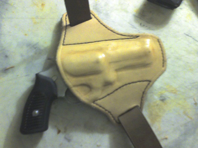

this place is awesome. thanks for lettin me in. here are some pics of a few i've made recently... the last 2 pics are of a bag i made for my bike. i lined it with an old pair of camos and rivited a holster for my 1911 in the large cargo pocket.
