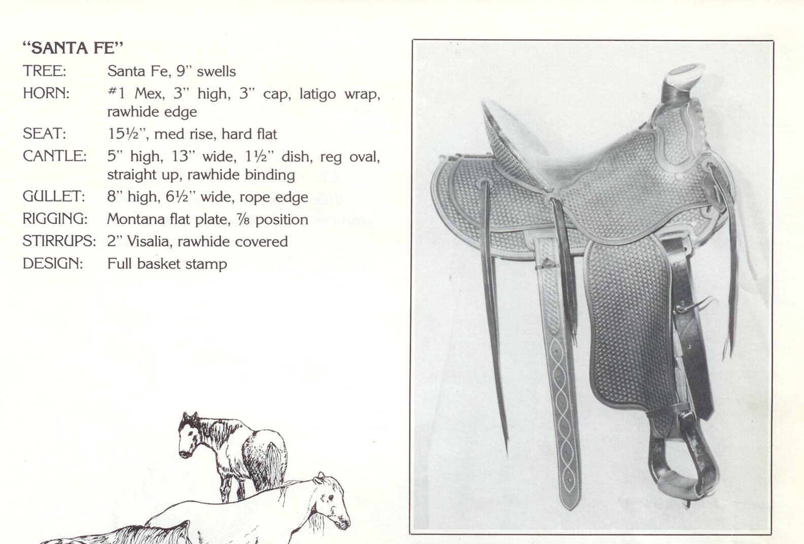

Members rookie Posted April 7, 2009 Members Report Posted April 7, 2009 Well I am starting to get my ducks in a row. I am wanting to build a saddle. I am in the info stage right now. I have found a saddle that I would like to build. The only problem is I don't know what tree the saddle is built on. I am planning on having my tree built by Timberline, brfore I call Timberline and sound like a Gunsel, I was hoping someone could help me identify the tree. The saddle in the picture is from a catalog from Bridger Creek Outfitters in Bozman MT. This catalog is from the 80's. I tried contacting Briger Creek, no longer around. Any help will be appreciated. -Justin Quote
Members jbird Posted April 7, 2009 Members Report Posted April 7, 2009 I would stab at it and say it's a bowman style tree. Josh rookie said: Well I am starting to get my ducks in a row. I am wanting to build a saddle. I am in the info stage right now. I have found a saddle that I would like to build. The only problem is I don't know what tree the saddle is built on. I am planning on having my tree built by Timberline, brfore I call Timberline and sound like a Gunsel, I was hoping someone could help me identify the tree. The saddle in the picture is from a catalog from Bridger Creek Outfitters in Bozman MT. This catalog is from the 80's. I tried contacting Briger Creek, no longer around. Any help will be appreciated.-Justin Quote
Members Tosch Posted April 7, 2009 Members Report Posted April 7, 2009 Well, the catalogue says Santa Fe tree. So let us assume it is one. Seems like Timberline builds a Santa Fe tree. Scroll a bit down here http://www.sawtoothsaddle.com/saddles.php?cat=Old-Time close to the bottom of the page are 2 saddles said to be built on a Santa Fe tree. Sawtooth saddlery is in the same town as Timberline and they get their trees from Timberline... Tosch Quote
Members rookie Posted April 7, 2009 Author Members Report Posted April 7, 2009 Tosch said: Well, the catalogue says Santa Fe tree. So let us assume it is one. Seems like Timberline builds a Santa Fe tree. Scroll a bit down here http://www.sawtoothsaddle.com/saddles.php?cat=Old-Time close to the bottom of the page are 2 saddles said to be built on a Santa Fe tree. Sawtooth saddlery is in the same town as Timberline and they get their trees from Timberline...Tosch I was under the impression that the sante fe had the cut outs on the seat. If I as for a 5" seat with out the cut outs, I am assuming I will get what I want. Is that correct? Quote
Members Tosch Posted April 7, 2009 Members Report Posted April 7, 2009 The best advise is - call Timberline and talk to them! They were nice and friendly when I pestered them with my amateuer questions for 2 hours when I stopped by. Just explain what you want and like. Ask for Randy who runs the company, or for Aaron (his brother?) if I remember his name correctly. When I called them before I visited I simply asked to talk to someone knowledgeable about trees - and got to talk to Randy. I assume they are still nice and friendly. Their phone # is 435-789-8228. Tosch Quote
Members rookie Posted April 7, 2009 Author Members Report Posted April 7, 2009 Thank you for the info. Quote
Members oldtimer Posted April 9, 2009 Members Report Posted April 9, 2009 rookie said: I was under the impression that the sante fe had the cut outs on the seat. If I as for a 5" seat with out the cut outs, I am assuming I will get what I want. Is that correct? [/quot You can order a Santa Fe tree without the hand holes from Timberline,and I think you´ll get what you want. / Knut Quote
MarkB Posted April 9, 2009 Report Posted April 9, 2009 rookie said: Well I am starting to get my ducks in a row. I am wanting to build a saddle. I am in the info stage right now. I have found a saddle that I would like to build. The only problem is I don't know what tree the saddle is built on. I am planning on having my tree built by Timberline, brfore I call Timberline and sound like a Gunsel, I was hoping someone could help me identify the tree. The saddle in the picture is from a catalog from Bridger Creek Outfitters in Bozman MT. This catalog is from the 80's. I tried contacting Briger Creek, no longer around. Any help will be appreciated.-Justin Justin Timberline makes the trees the way you want them as do most tree makers. if you like that tree that is in the picture if you talk to timberline and give them the information that is with the picture they will be able to make that way. You will only need to figure out the bar type that you need. I'm not a professional but have ordered some trees. Good Luck with your saddle and hope this helps. Mark Quote
Members rookie Posted April 9, 2009 Author Members Report Posted April 9, 2009 MarkB said: Justin Timberline makes the trees the way you want them as do most tree makers. if you like that tree that is in the picture if you talk to timberline and give them the information that is with the picture they will be able to make that way. You will only need to figure out the bar type that you need. I'm not a professional but have ordered some trees. Good Luck with your saddle and hope this helps. Mark Mark-Thank you for your reply. Everyone has been a great help. My only question is, if I order the tree and it is not what I wanted do I get to blame all of you. Just kidding. Seriously, you guys have been great, Thank you again for your help. Quote
