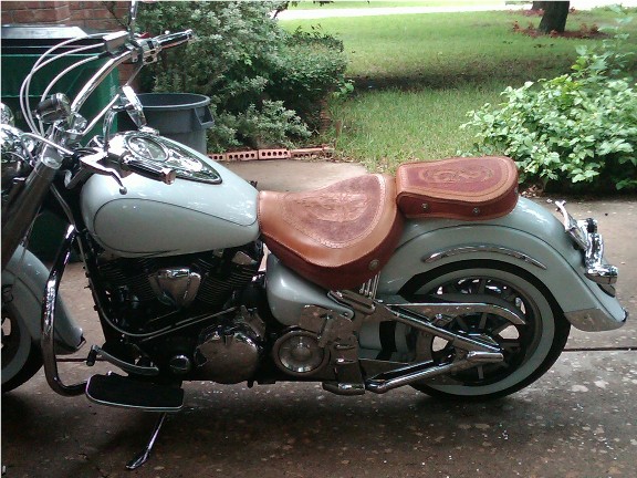

post-9688-0-91091200-1357274992_thumb.jppost-9688-0-09266100-1357274994_thumb.jppost-9688-0-88250800-1357275053_thumb.jppost-9688-0-98291800-1357275054_thumb.jpSorry all, this was an old post and didn't update it with the seat once it was done. Here is a picture of the seat after completion, remember it's 4 yrs and about 10K miles old. The funny thing is I'm remaking a new one now, I've included a couple of pics of that, just need to finish punching the sides and lacing it up.
