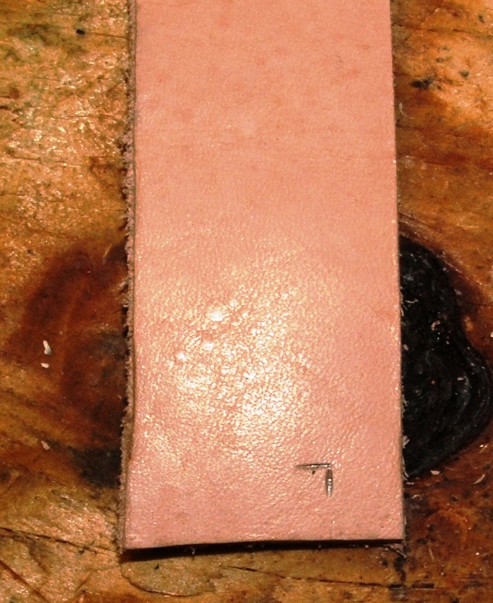

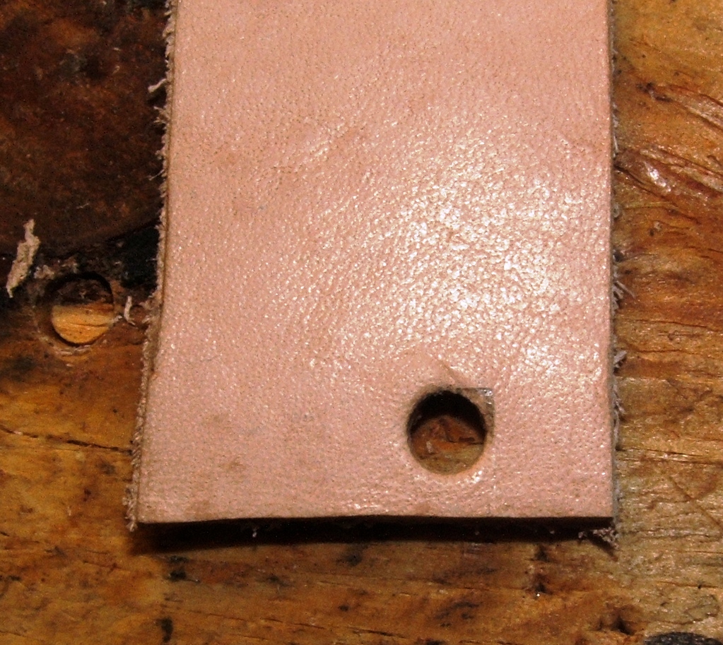

I measure in from the side and mark and then I measure down from the top and put a mark. I use these two marks to line up the edge of the cutting tube. This works better for me than trying to center it on a single mark. The rivet will cover the marks when you put it in, or you can mark on the back.
