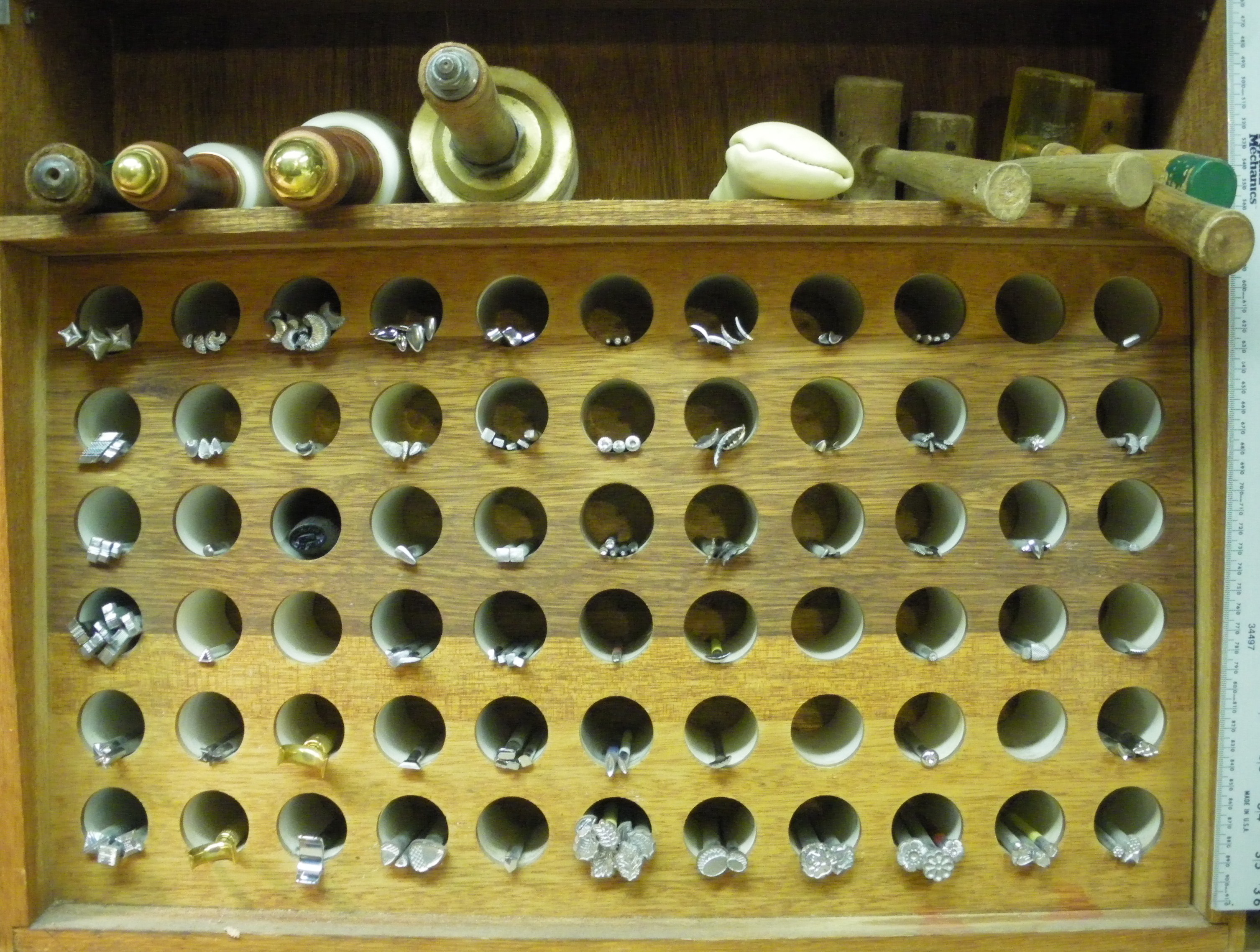

MarkB Posted April 30, 2009 Report Posted April 30, 2009 Well here is my tool rack. I made it back in high school. I plan to make a new one sometime soon. It is made with 1 1/4" pvc pipe and a piece of mahogany wood. I used a dill press and drilled a hole the same size as the OD on the pipe 1/2 way then drilled a hole the same as the ID of the pipe the other 1/2, on the front piece of wood. I then drilled a hole 1/2 way though the back piece of wood the same size as the OD on the pipe. I set the pipe at a slight angle to help hold the tools in better. Then in cased the two pieces of wood together to make it like a cabinet. I like the way it holds the tools were you can see all the tools at one time. Works good for me. Just another type of tool rack. I really like what Bob is talking about with the other tools on a bench. Really like the 45 deg. angle thing sound like it will really save space. Mark Quote

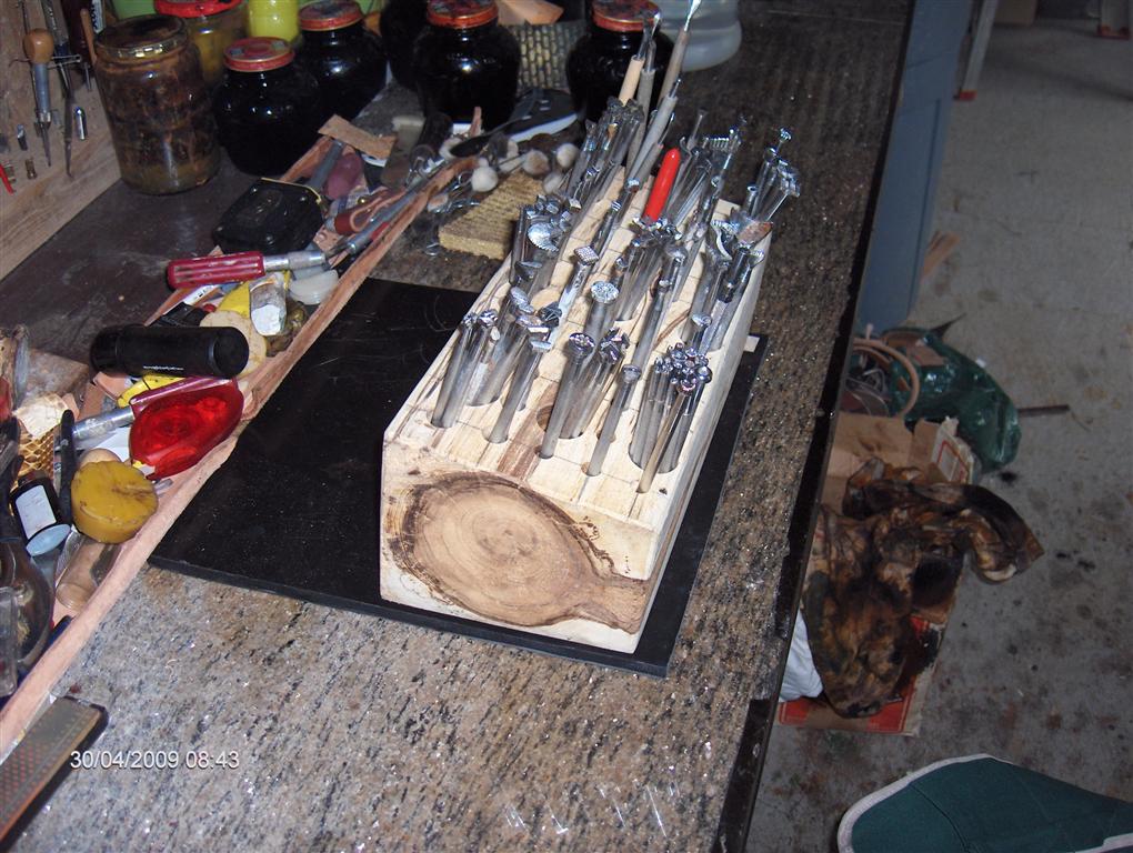

Contributing Member rdb Posted April 30, 2009 Contributing Member Report Posted April 30, 2009 Nothing fancy here... Just went out Sunday, and chainsawed down a broken oak in the yard. Shaped it with the chainsaw, and hand planed it smooth. Three different sized drill bits made the holes. Voyla!..semi instant tool rack. Quote
Members tonyc1 Posted April 30, 2009 Members Report Posted April 30, 2009 Like it. It looks great! Tony. Quote

Members KnotHead Posted April 30, 2009 Members Report Posted April 30, 2009 rdb said: Nothing fancy here... Just went out Sunday, and chainsawed down a broken oak in the yard. Shaped it with the chainsaw, and hand planed it smooth. Three different sized drill bits made the holes. Voyla!..semi instant tool rack. I really like your rack. Best of all of this rack is the incredible oak characteristics. Nice job... Quote
Contributing Member rdb Posted April 30, 2009 Contributing Member Report Posted April 30, 2009 (edited) KnotHead said: I really like your rack. Best of all of this rack is the incredible oak characteristics. Nice job... Nobody ever thought I had a nice rack before...rofl! But thanx anyways. Me and my chainsaw have made quite a few necessities. It only took about 10 minutes of hand planing to get it to where you see it. Not sure how long the green wood will last without cracking, but we'll see. Just to keep this thread on track, I know UKRay is looking for a more finely finished and practical piece. Some of the ones above are incredible. Sure hope I see more examples. In my messy world, it sure would be nice to see work stuff crafted as nicely as furniture like some of these....but once a slob...lol Edited April 30, 2009 by rdb Quote
