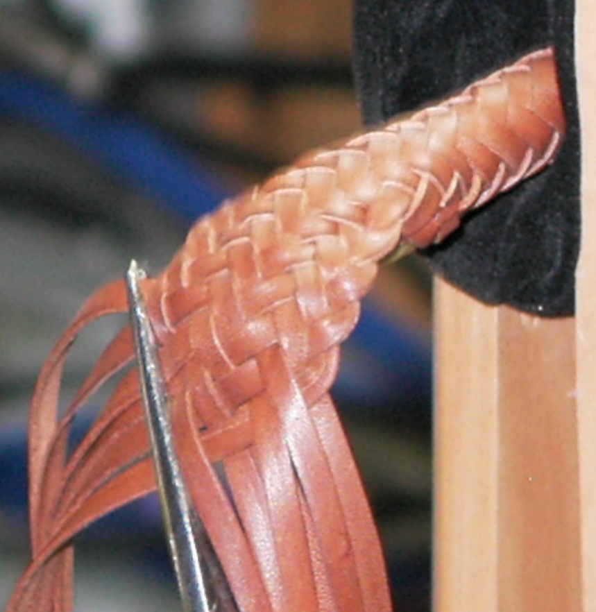

Close up of where I brought it together at the top end and the start of the herringbone braid.
Close up of the actual herringbone braid operations.

Nice... personally I prefer this to the 4-strand braid normally seen... but then I'm a braid-a-holic, and if you'd done it in 36 strands I'd have liked it even better! :lol:

And btw, that is an awesome braid you're doing there. I like the backbraid. Can't wait to see the finished product. Twelve is as high as my old ham hands can go anymore.
Edited by Spence
Thank you Spence. The back braid took about 30mins just to get it like you see it in the photo. Oh, I forgot to say; that this is the first ever herringbone dog lead I have ever done. Seeing the replies being so positive is inspiring to me. So the finished product I hope will bring even more positive returns as the build is.

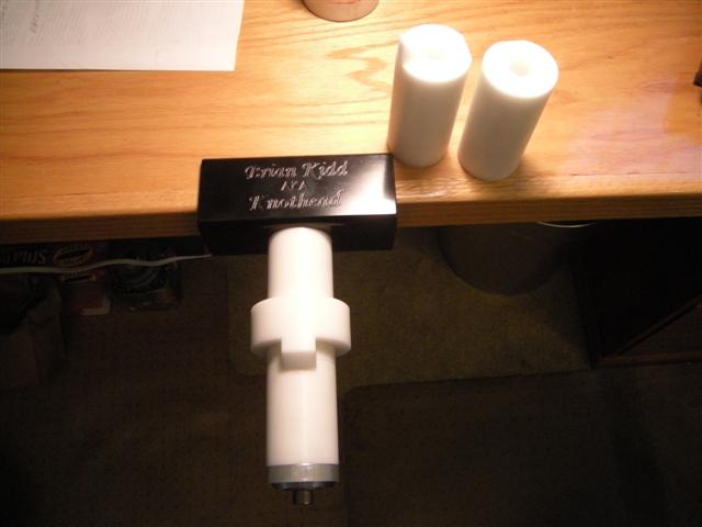

I got my new cutter / beveler today. Woo Hoo!!! I'm gonna be playin all weekend, ehehehehe... I need to get used to it and learn it really well. Oh yeah!! I'm gonna be cuttin it up this weekend.

Well the creator of the tool I had made for me I sent an email to and asked him your question. I will post to you in PM when he answers back.
I have 3 degrees I can cut roo at.
1. 90 degrees
2. 30 degrees
3. 45 degrees
That's what those extra pieces are for you see in the back ground. They are interchangable depending on what angle I need to cut at and the project I am cutting for.
The material that was used in the making of my new tool is Steel for the clamp down on a bench and for the center rod that holds the interchangable pieces and the screw down cap at the end that tightens against the delrin cutting surfaces which holds the injector blades tight. The interchangable pieces are made from Delrin. Delrin is a very, very strong polymer known to be as tough as steel. But without all the weight to it. I thought that the delrin would be better than the stainless steel inserts for roo hide cutting. The stainless steel will rust eventually, whereas delrin will not. Stainless steel will burnish your roo hide cuts a little. The delrin does'nt do that. I had a few tweaks I needed on the tool and that was the 30 degree cut as an added insert. I like the 30 degree cut for very wide lace because it will tend to lay flatter on the surface of the braid. It will also take very, very little roll out to smooth the braid down with roo hide. Just about any lace can be beveled, but the result is just not the same as you get with roo hide.
