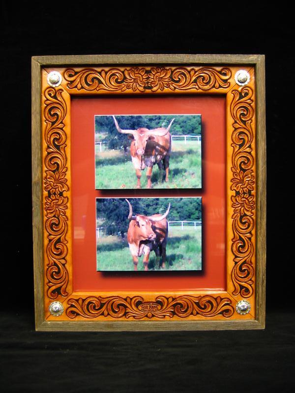

Spence,
I do frames from time to time and have never used anything but Barge on them. It works very well. The frame on the right has a tooled piece of leather on top of ostritch. It's all just glued.
Hope this helps!
Bob

Thanks for the hints, Shawn and Bob, that is awesome work. I'm a long way from tooling though. I may do lacing applique, but the rest will be knots and sennets. (hopefully) Thanks
