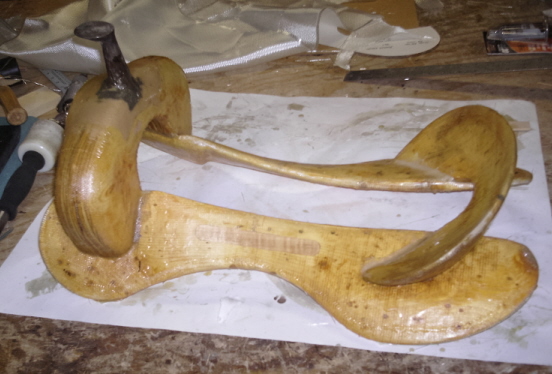

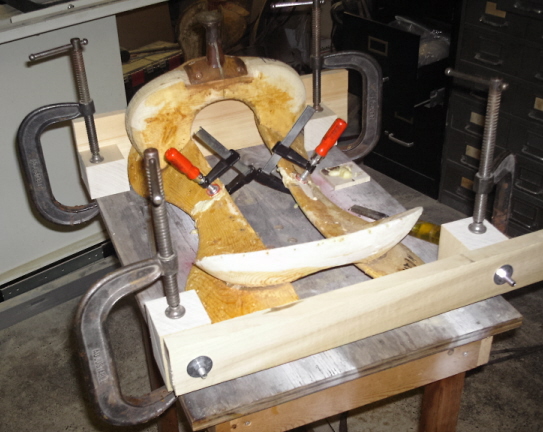

Members jonwatsabaugh Posted March 13, 2008 Members Report Posted March 13, 2008 Ryan, From time to time I'll take in a repair job in with a broken tree. Since I make my own trees ,duplicating them isn't a real big problem but I prefer to strip the tree and fix it even if it's severely broken. I have about the same amount of time involved and the repair challenges my thought process, and everything fits back perfect. The last one I did was by far the worst as far as the breakage was concerned. Both bars were broke cleanly in half, and the fork and cantle were both split. From the looks of it, it appeared to be a Hadlock&Fox tree and the wood was pretty crude but it did have a nice bar profile on the bottom side. Since this one was a very extensive repair I took pictures progressively of the process to show how this is done. After final gluing, I double fiberglassed it (some places triple) then covered it with rawhide at the customers request. I have a lot more faith in a good fiberglass job than I do a good rawhide job by the way. He won't break it now unless he runs over it with his John Deere. I posted some pix of the process. I would be glad to help you out if you like. Jon Quote
Members jonwatsabaugh Posted March 13, 2008 Members Report Posted March 13, 2008 My computer would'nt let me upload everything the first time so here is another pic Jon Quote
Members steveh Posted March 13, 2008 Members Report Posted March 13, 2008 Jon, That is a really neat tree repair.The bar repair looks like you glued a hardwood plug thru the bar? Is photo #3 been fiberglassed? How did you repair the fork and the cantel? Thanks, Steve Quote

Members jonwatsabaugh Posted March 13, 2008 Members Report Posted March 13, 2008 Steve, After I glued and clamped the bars together, I milled a slot completely through the bar and made a beam of hard maple for a light hand press fit. Holes were then bored through the bar edges and pinned with dowels. This part of the assembly was secured with Gorilla glue. The fork and cantle were glued and pinned also. I removed the horn and reset it in Kevlar based epoxy. Photo three does show the tree fiberglassed, semi-finished. There are a lot of those old saddles out there with that useless cheese cloth covering on the tree that could have their life greatly extended by simply doing a quality “glass” job. Good fiberglassed trees just don't break. Ask the steer trippers and calf ropers down in Texas. Troy West has a great story concerning glass trees, I hope he will post it someday for all to read. Jon Quote
