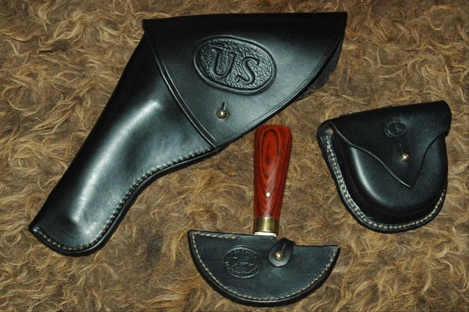

Here is a few things I vingarooned...after my testing I just rinsed my leather well with water cause I was more afraid of the alkali than the acid since the vinegaroon was so close the the leathers PH. I did some other testing as well...one piece I stuck in the flume spring of my wood stove and baked it dry and left it there all day...I was able to bend the Wicket & Craig double without it cracking. I oiled it and tossed it asside, several months later the test piece is still nice and supple.
Oh yeah...it still stinks LOL
