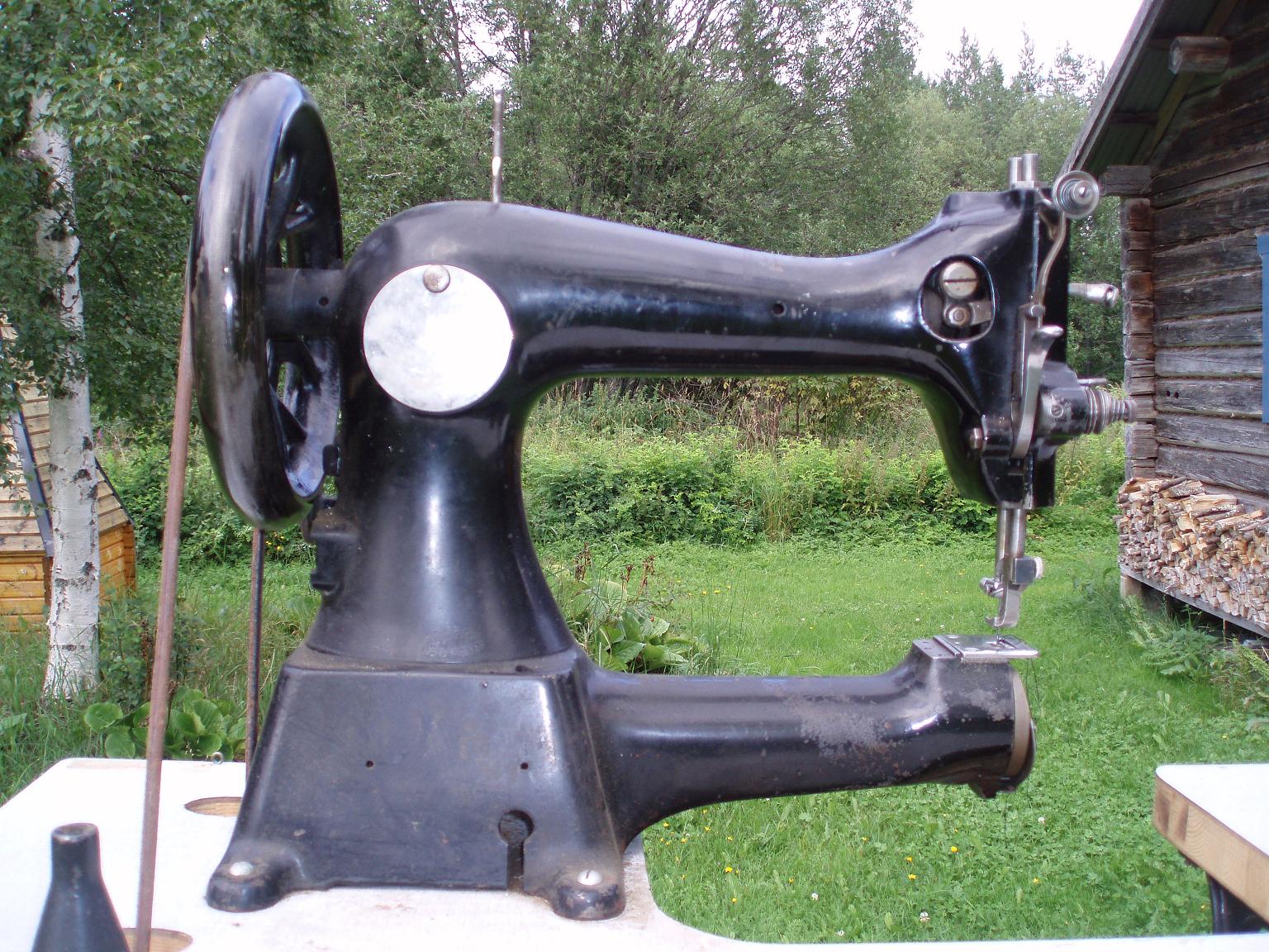

Picked up the machine today ( been on a vacation in Denmark last week) and cleaned it up. The most obvious differences are : The flywheel is heavier on the KSV49 than on the 45K21 and the needle plate is flat on the 49 and domed on the 45K21.
I threaded the machine and .... it sewed perfect (without any adjustments,) better than my K21, so they changed places in my shop.
