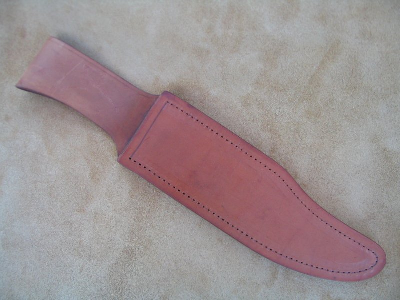

A guy came into the shop recently looking for a simple sheath for a knife he made and though he didn't want to spend much, I thought it would give me the opportunity to get some practice in on a paying job and to try the techniques Dwight explained. I used an old skin I have which I'm guesing is around 10 oz. for the body and some horse hide for the back panel/belt loop. I hope I'm in the right place being that I'm continuing Dwight's reply but I'm also looking for some hard critiques of my methods. So, here it is glued up with a line scribed on the front only with my dividers as Dwight suggested
Next I punched holes with an unthreaded needle so I could see step by step what's going on with my stitching.
I didn't scribe a line on the back until I punched the holes so I could make sure they lined up ok. So after they were punched I ran the dividers over the holes again front and back to see if it would smooth them out some.

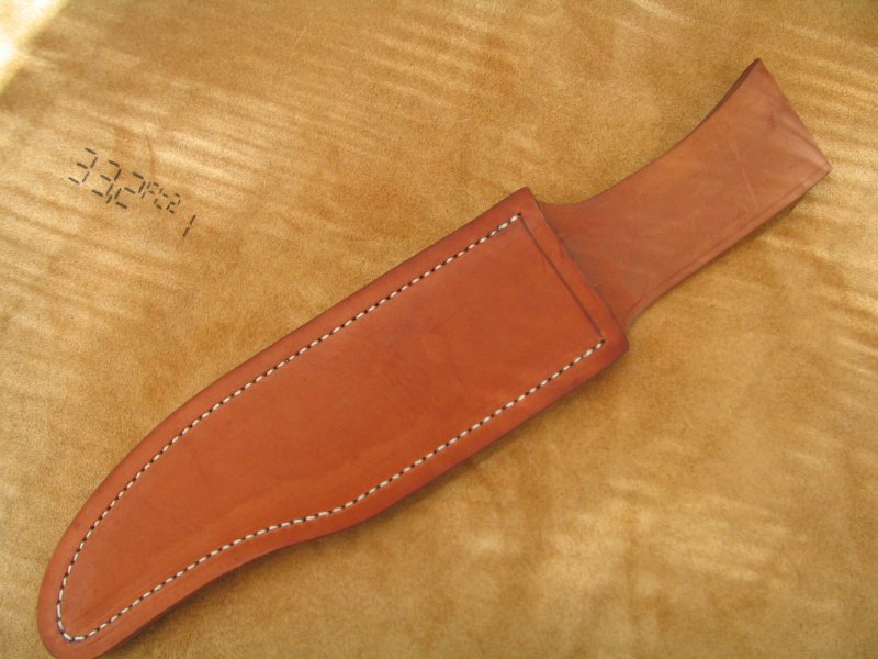

stitched

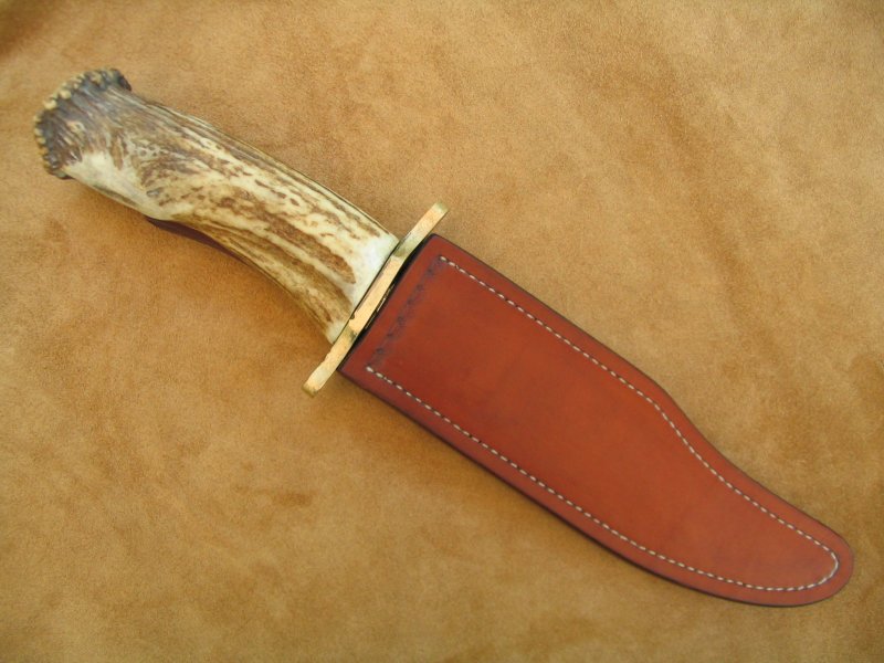

burnished damp, oiled with neatsfoot and then aussie wax
One thing I left out was that before I glued it up I put a couple coats of satin sheen on the inside to seal it like I've read here, but either I didn't let it dry long enough or it's the wrong stuff to use because it or something was coming off onto the knife blade. Today I stuffed some aussie wax down in there and it seems better. I'm kind of putting myself on the spot before I'm ready to take in work, but I figured what the heck, I have to start somewhere, so I would really appreciate any comments so I won't have to sweat the next one out as much.

Thanks pancho47....I did get a retainer strap on it but forgot to take a pic
