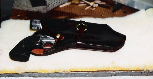

Members Dwight Posted August 5, 2009 Members Report Posted August 5, 2009 yldbill, . . . looking at the link, . . . the bottom picture (silver scope on belt mounted holster), . . . is the model of one I made some time back for a fellow to use his Ruger .22 auto with a scope. The problem I had, . . . he had one of those big green plastic front sights on his pistol, . . . as well as the scope, . . . and I had to work around both. I wound up building a holster similar to the picture, . . . with the front of the holster cut out far enough down that the weapon actually had to be tilted into the holster, . . . muzzle first. Point the weapon to the ground about 5 feet behind you, . . . in goes the muzzle, . . . tilt back and straighten up the weapon, . . . and it positioned itself so that the entire weight of the weapon was held in place by the front of the trigger guard. I fully lined it with suede leather, . . . contact cemented and machine stitched, . . . and finished it with an "over the top of the grip" snap strap that holds the weapon in the holster. The strength of the whole thing came from the bottom of the holster, . . . from where the trigger guard meets the grip all the way out to the muzzle end, . . . the holster was just shy of a full inch thick. I used my Tippmann sewing machine to make the holes through the leather, . . . but I had to end up hand sewing it, . . . the machine could not work on that thick of leather, . . . kept breaking my thread. I forgot to get a picture of the thing, . . . wish I had, . . . because I really believe it was one of the prettiest ones I ever made. Good luck, . . . it is a project, . . . but it can be done. May God bless, Dwight Quote If you can breathe, . . . thank God. If you can read, . . . thank a teacher. If you are reading this in English, . . . thank a veteran. www.dwightsgunleather.com

Members katsass Posted August 16, 2009 Members Report Posted August 16, 2009 yldbill. Here is a holster I did for a gentleman last year. It's for a Colt target gun that he uses in Steel Challenge matches. It has a red dot glass on it. I used the same method I learned about 40 years (or more) ago (shown here on a 1911 holster) I start with an inexpensive manila file folder, lay the gun, sights down, in the fold; lay the gun over and trace the outline (on one side only) up to the fold. Remove the gun and start working a design 'till I like the aesthetics, cut it out and.....go for it. The last pic is of the 1911 holster (plus mag pouch) made from the pattern shown in pics #2 & #3. Mike Quote NOTE TO SELF: Never try to hold a cat and an operating Dust buster at the same time!! At my age I find that I can live without sex..........but not without my glasses. Being old has an advantage.......nobody expects me to do anything in a hurry.
