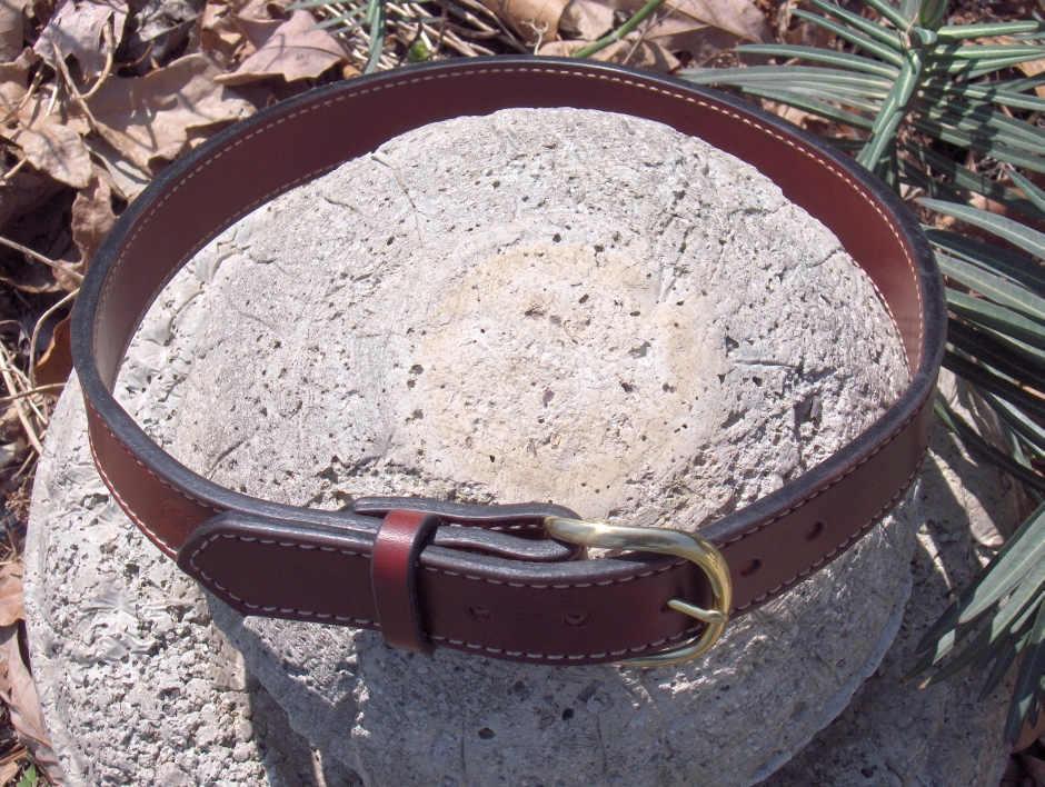

So, just getting used to my new 3000 sewing machine. Pretty damn terrific, is all I can say.
Anywho, I made up this cc/od belt just to try it out. Like going through butter.
This is made from two layers of 9/10 Bridle Side Leather I got from Zack White. Real purdy stuff. What takes time is the edge. I got it pretty good, but could have done a little better. working these edges by hand will sure enough strengthen you up!. First I dye it. Them apply some gum Trag...a lot of hand burnishing...then I rub beeswax over all that to fill in any small gaps.A final burnish then a coat of Wax Balm. It was five minutes of sewing with 277 nylon thread top and bottom.
I split the billet and buckle ends back about 10 inches to get a little less bulk in front, but it's still about 1/4 in thick doubled over there. I might thin it down a little more on the next one. The rest of the belt comes out at about 3/8 in thick.
I ran a stitching groove both back and front to sew into. That makes for less wear and tear on the stitches from the holster.
Tooling around the internet for these shows mine to be pretty up there in quality. I didn't see any of them with the stitching in a channel. Most are made from veg tan, with the inside layer being left natural. With the drum dyed bridle layer, you shouldn't have any problem with bleeding.
I finished off with just conditioner, and a buff.

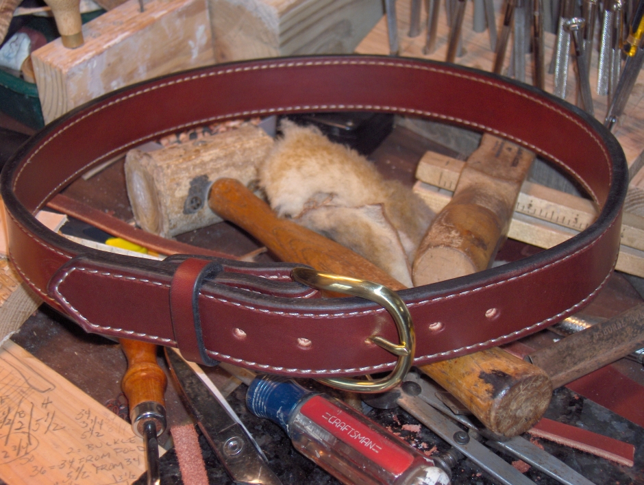

Looks good. I just finished one myself. Like you said all the ones I've seen have been made from Veg tanned leather. Whats the difference in that and the Bridle leather?
Jason
  • Contributing Member
Bridle is a veg tan too, but it's "stuffed" up with tallows, and oils and such til it's almost bursting with the stuff. It's drum dyed so the color is deep into the leather. IMHO it's about the best belt leather you can buy. Just picking it up and feeling it will tell you, this is what leather should be.
