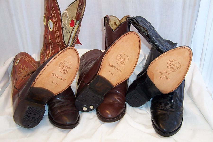

The machine you bought will not sew your shoe soles. It takes a "sole stitcher" machine to do it correctly. You can Hand Sew them but you said you wanted to get away from that. If you decide to do this yourself after getting all the supplies cut your pattern for your sole, skive the backside transition to match the skive and transition you make on the shoe/boot.
Apply glue to both and let tack up. Lay soles on and hammer them to be sure they are stuck on. Pinch the welts/soles areas to be sure the welt is glued solid. On the underside of the sole groove out a stitch groove so your threads will be under the surface of the sole (so you don't wear the stitches out) use a dremmel and small bit and drill stitching holes. You can "hook and loop" stitch or double needle your holes to sew them up.
Sand the sides smooth, finish with edge polish, sand your tranistion skive area near the heel smooth and sink a couple shoe brass tacks to help hold the skived area. I seal the new sole with some polish, only to make it look more finished for the customer, it comes off when they walk on it but looks good when they pick them up!
There are some uTube vid.s on this subject. We sell a Cowboy Boot Resole Kit on our Ebay store and have sold a few, some old shoe repair guys and some cowboys out in the sticks with a lot of time on their hands I guess. We are in the process of a uTube vid. to go with our kit but have not finished it yet. This process is doable with out special machinery but you need some direction and simple hand tools and that is what we are trying to put out there on our uTube vid. I wish it was done, it could make some procedures clearer.
