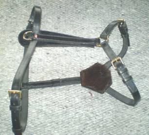

I used to make (and still do, when asked) leather harnesses (example in the first photo). The Police Force I worked for had been using leather tracking harnesses for years but decided to go for an 'easy care' harness and chose, for many reasons, a nylon one (second photo).
One problem they had with the leather styles was a problem with forward 'slippage'. I think this was because the harnesses were issued regardless of the size of the dog and, though they were adjustable, it was impossible to make one that would fit all sizes of dog from dainty spaniel to huge GSD.
I made (ashamed as I am to admit it) the nylon harnesses for our dog section and they did seem to work well. However, some of the dog handlers approached me and purchased, privately, custom made harnesses as there was still a 'slippage' problem if they weren't correctly fitted/sized.
And I vastly under-priced the first consignment of harnesses, by the way, but learned my lesson on that one.
Just my thoughts and experiences.
Gary

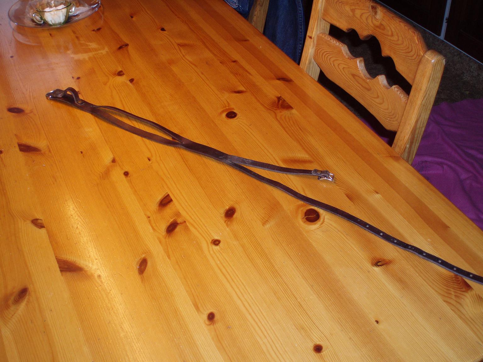

Well, you were correct to a point about changing measurements. Sorry it has taken so long for me to report back--I have been quite busy lately! In any case, I did decrease the size of the slit for the dog's head by several inches, as well as decreasing the non-slitted portion in front of the chest by one inch. That does prevent him from stepping out of the harness if it is pulled forward. Unfortunately, it didn't solve the problem of the back of the harness (section with the dee-ring) pulling up and over his back if you pulled it forward to get him to move with you. To solve that, I actually REMOVED part of the design :P. I removed the loop on top that the chest straps go through, and simply made the loop around the dee-ring a little more open so that the straps can run through it instead. That seems to have resolved that issue quite well. Here are some crappy pictures :P
The overall harness, freshly oiled and in bad lighting:
The dee-ring/chest-strap loop (that's a 1.5" dee-ring, my hands aren't really that small):
Thanks for looking!
~Noah
