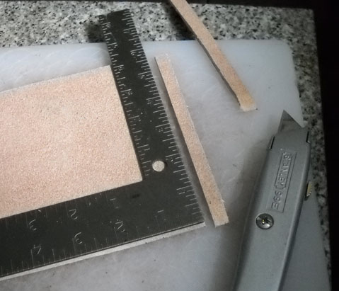

This is just a personal preference, but I will edge bevel the top edge of the barrel, on the outside only. You can fiddle with this to see what you like best.
Next, you will want to skive the inside of the bottom edge of the barrel, about half of the thickness of the leather and about as high as the base (the portion of the base that was covered by the hose clamp). Again, this is optional, but stitching through 1 1/2 thicknesses of leather by hand is easier than stitching though 2 full thicknesses of leather. WARNING: If you do this, make sure you're skiving the BOTTOM edge! Yes, I have skived off the top edge before...

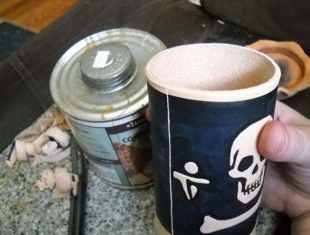

Check the fit again by wrapping the barrel around the base again. The amount of overlap should be about 1 inch. NOTE: The 1 inch rule is not a hard, fast rule. I go with 1 inch because it seems to give enough overlap that the seam is not prone to bending/flexing which would crack the lining. Also, 1 inch is the width I make my handles, so the stitching lines up with the handle pretty well.
When you have the overlap to the right size, skive the edges down. This will keep the thickness of the barrel fairly even at 1 thickness the entire circumference of the mug. I skive the outside edge on one side, then the inside edge on the other.
To make stitching so much easier, I just glue the barrel closed, lining up where I skived the edges. I've been asked whether the glue would be bad if you're actually going to drink out of the thing. I honestly can't say no way, but consider this. The leather mug will be completely saturated with beeswax, then the inside coated with a mixture of beeswax/brewer's pitch, so there's very little chance of that happening. But, go with what you're comfortable with.

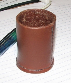

Sealing the Mug
Here shows the mug sealed. I probably needed to have more pictures of the process here, but I was in a hurry. If there are enough questions or requests, I'll post some more pictures of this portion. You'll see my double boiler here. The old pot is at the very top edge of the picture, and the old tin can is the other part. The mixture in the double boiler is roughly a 50/50 mix of beeswax and brewer's pitch. After it is all melted, I take the tin can out of the pot, dry it off, and pour the mixture into the mug. I then set down the tin can and take the mug. I slowly pour the mixture back into tin can, rotating the mug as I do, so that the mixture coats all sides of the mug. I usually start around the stitched seam and end up over the seam. I do this three times, going in opposite directions each time. This helps to create an even coat all the way around the inside of the mug.
After you seal the inside of the mug, check for dribbles of the sealing mixture that may have leaked out somewhere. In the picture, I had one stitch hole that hadn't sealed completely when I waxed the leather.
This is something that I just started doing. After the beeswax/brewer's pitch mixture has started to cool down, I scrape off the top of the mug. The rim of the mug, if you left the wax/pitch mixture is a magnet for lint and such. And since we wax-saturated the leather, you really don't need that stuff on the rim. To scrape off the wax, I use a bamboo skewer. After I get the majority scraped off, I can clean up the outer edge, then with a wet fingertip, I can smooth out the inner edge.
Final touchups... Burnish the inside of the handle. The waxed leather makes for a fairly rough flesh side to the leather, but it smooths down easily.
OK, you're done!!!

Pictures would be great. I thought about slotting my dowel base template with a router bit to give it the outward angle of a real shot glass but I just started with simple. At that size, they are pretty tough to stitch. Not that I proclaim any expertise.
I finally finished my first four mugs today! Here are some pictures. The really big one was my first mug and it holds 33 oz. The other mugs with the exception of the one that is a little short (It was the last scrap of the hide I was using) hold 16oz. Two of the mugs have two layered handles. Let me know what you guys think! Thanks again to Angster for his amazing tutorial and his many replies to my many questions as well as the help of others on this forum! :)
Nice mugs mate, i have been waiting for these any following the progress, the hammer finish looks good, like the colours too, what did you use, i tried again to get the reptile effect but no luck even with the wax at 200 deg.C in the deep fat frier, your work NICE. and again thanks to angster for his help to me when i made my first mugs.
