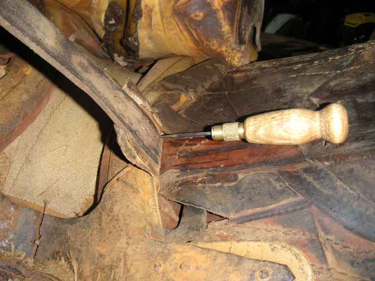

Onsite Tack Report post Posted May 4, 2008 I have attached 3 pictures of this pesky saddle so you can see what it looks like underneath. It does not look anything like Dave's pictures, unless Dave has already removed the padding. I was working on this saddle this evening and it sure seems to me that I have to remove all of this padding (see pictures). Of course, I can be rather dense, too. Thanks, everyone. Kathy Quote Share this post Link to post Share on other sites
barra Report post Posted May 4, 2008 (edited) Kathy. If you use David's second pic in the left column you more or less have your pic 3 after he has cut the stitches holding the front of the panel up. On your pic 3. Have a look at the thin strip of brown rolled leather. This is called the front facing. Just on top of that I can make out the white stitches that need to be cut (and pick out). If you cut these stitches you will be able to push the front of the panel up and out of the way like David's pic 2, left column. When the billet strap is replaced you re stitch in the same holes you have at the front. Barra The brass (ish) hardware you have on the top of the saddle are from front to rear 1. D probably to attach a breastplate 2. Saddle staple. A duster or wallets/pommel bags can be attached here 3. The saddle nail. This should be simply holding the flap and skirt down to the tree 4. Drop down saddle staple. Just a different type of staple and is used like the first version Edited May 4, 2008 by barra Quote Share this post Link to post Share on other sites
