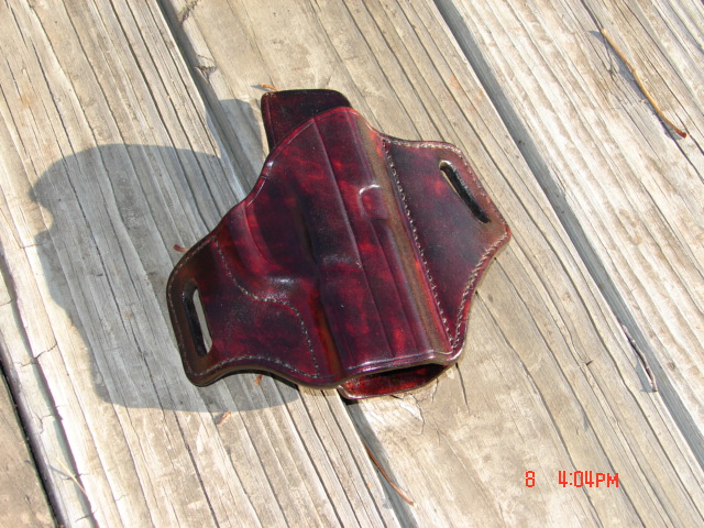

Members rybord Posted November 20, 2009 Members Report Posted November 20, 2009 Here's a holster I just finished and wanted to share and would appreciate your opinnions. Thanks, Ray Quote
Members Bronson Posted November 20, 2009 Members Report Posted November 20, 2009 Looks nice to me. Were you going for that effect in the dye or did it just kinda happen? Bronson Quote
Members rybord Posted November 20, 2009 Author Members Report Posted November 20, 2009 Looks nice to me. Were you going for that effect in the dye or did it just kinda happen? Bronson The coloring was asked for based on others I have done. It's for a FN in 357 Sig. The first time it did just kinda happen but now for the few that I make, that's what they want. Thanks, Ray Quote
Members katsass Posted November 20, 2009 Members Report Posted November 20, 2009 Here's a holster I just finished and wanted to share and would appreciate your opinnions. Thanks, Ray Very good looking work Ray. The only thing I see is that I prefer to sew around the belt sockets. holes, loops (or whatever you want to call them) To me it finishes the look a little and decreases stretching in that area. Most likely it's more cosmetic than anything else, but I think it also gives the appearance of ensureing that the leather inside of said loop will not separate (which I'm sure is highly unlikely). Mike Quote
Lobo Posted November 20, 2009 Report Posted November 20, 2009 Exceptionally nice workmanship. It appears that your inner panel is assembled smooth-side in? I like the effect of the dye work. Quote
Members rybord Posted November 20, 2009 Author Members Report Posted November 20, 2009 Exceptionally nice workmanship. It appears that your inner panel is assembled smooth-side in? I like the effect of the dye work. Thanks Lobo, It is smooth side in. I appreciate your comments!!!! I've been focusing on the stitch lines around the gun which I think is paying off. Thanks, Ray Quote

Members rybord Posted November 22, 2009 Author Members Report Posted November 22, 2009 (edited) Here are a few more pictures Edited November 22, 2009 by rybord Quote
Members BOOMSTICKHolsters Posted November 29, 2009 Members Report Posted November 29, 2009 'Good looking holster with a solid design. It doesn't look like there's a whole lot to critique. I would probably cut a little more off of the sweat shield to allow the thumb to set higher to make a stronger/more comfortable draw, but that's really the only thing I can think of that I would change. I guess you could run the rear slot a little bit closer to the pistol so it will hold the grip in a little tighter to your side, but it looks like it will do a sufficient job as it is. Nice work. Quote
Members dickf Posted November 30, 2009 Members Report Posted November 30, 2009 I agree with BOOMSTICK, it looks good! Your molding is nice and your pattern is well assembled and basic with good rounded corners. Looks like you measured your stitch line and muzzle end perfectly. Quote
Members rybord Posted December 1, 2009 Author Members Report Posted December 1, 2009 'Good looking holster with a solid design. It doesn't look like there's a whole lot to critique. I would probably cut a little more off of the sweat shield to allow the thumb to set higher to make a stronger/more comfortable draw, but that's really the only thing I can think of that I would change. I guess you could run the rear slot a little bit closer to the pistol so it will hold the grip in a little tighter to your side, but it looks like it will do a sufficient job as it is. Nice work. Thanks BoomStick, I creeping closer with the rear belt loop and I appreciate the advice on the sweat guard which I will change on the next holster. I've been focusing on my stitch lines and the modeling. I want to get my time down as well. Thanks, Ray Quote
Members rybord Posted December 1, 2009 Author Members Report Posted December 1, 2009 I agree with BOOMSTICK, it looks good! Your molding is nice and your pattern is well assembled and basic with good rounded corners. Looks like you measured your stitch line and muzzle end perfectly. Thanks, I have been trying to get the stitch lines as close as I can. Thanks, Ray Quote
