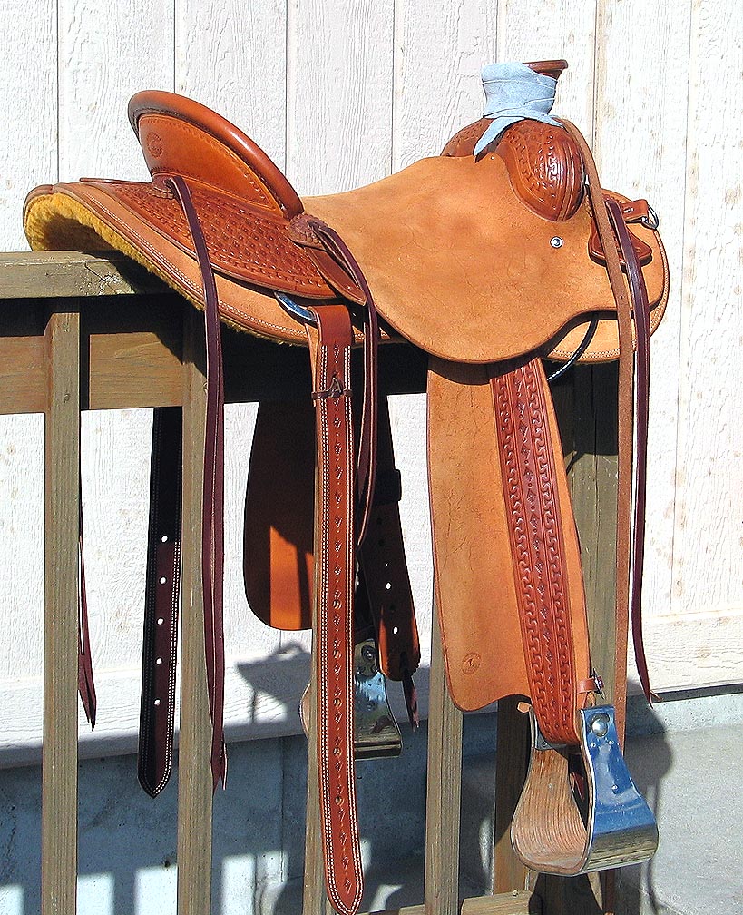

Members jwwright Posted February 18, 2011 Members Report Posted February 18, 2011 I have built only a few saddles on the LaPorte trees so far.........most of my orders are still for saddles on handmade wood trees. I do however, have a couple more orders for the cable rigged on my books. Below is a saddle I built on a LaPorte tree about 90 days ago. The man that owns it makes his living horseback all day, every day, and rides quite a few different horses. I heard from him yesterday................he loves the saddle, and gets along good roping out of it as well. JW Quote www.jwwrightsaddlery.com
Members steve mason Posted February 18, 2011 Members Report Posted February 18, 2011 I have built only a few saddles on the LaPorte trees so far.........most of my orders are still for saddles on handmade wood trees. I do however, have a couple more orders for the cable rigged on my books. Below is a saddle I built on a LaPorte tree about 90 days ago. The man that owns it makes his living horseback all day, every day, and rides quite a few different horses. I heard from him yesterday................he loves the saddle, and gets along good roping out of it as well. JW glad to hear the saddle has worked well for your customer JW, thanks for the update. Steve Quote check out www.stevemasonsaddles.com check out my saddle blog
