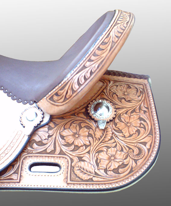

Hello, I finished this saddle a few days, is a barrel racing, of 15".
tell me what you think and any ideas for improvement.
Thank you.

Looks great to me! Really nice work on a very beautiful rig!
I'm not a Saddle Expert so I won't criticize anything. I think it looks very nice also.
Butch
Over all good job.
A few areas that I would watch and maybe do differently.
Block the rear of your skirts up higher between the bars. This is an area that is really important if you build saddles with longer skirts.
The front of the seat above the conchas could be improved.
Stitch your cantle binding with 2needles rather than pop stitch.
twist your stirrup leathers.
You must of had fun stamping the gullet!!
Good job of lacing the fork.
Beautiful!!!!
