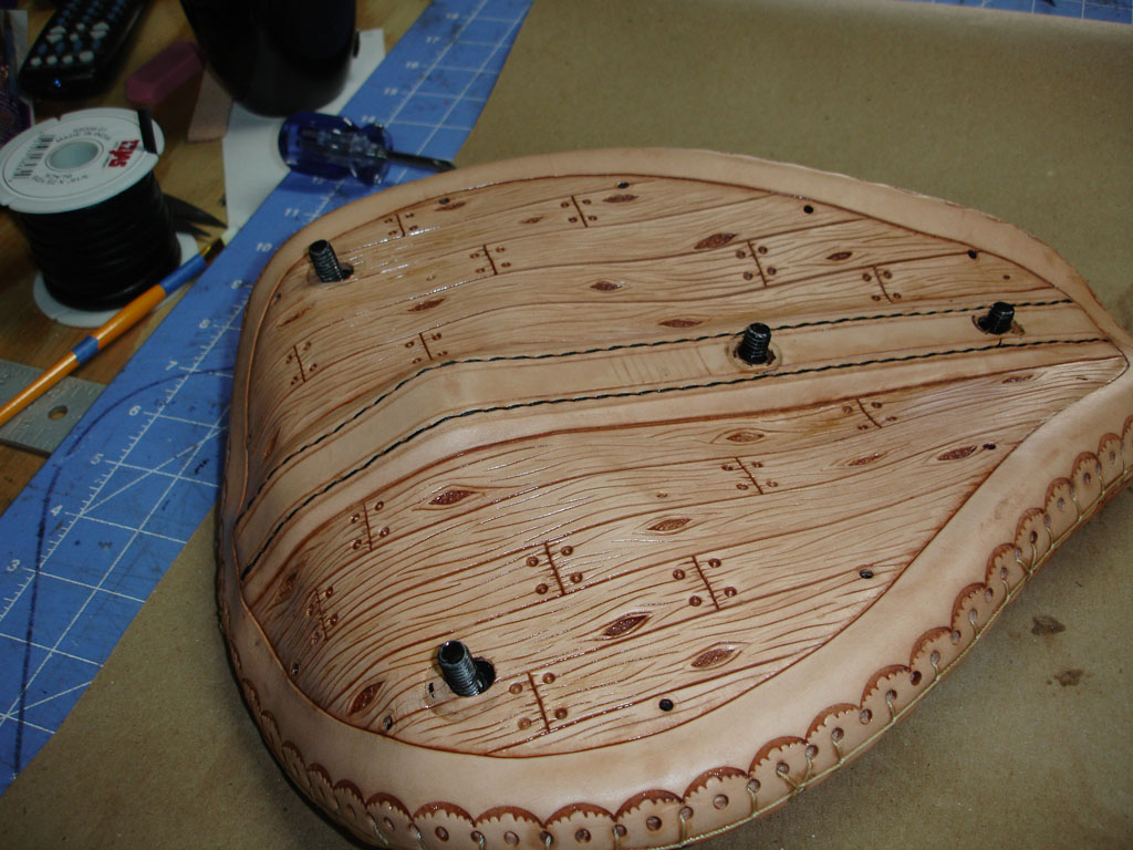

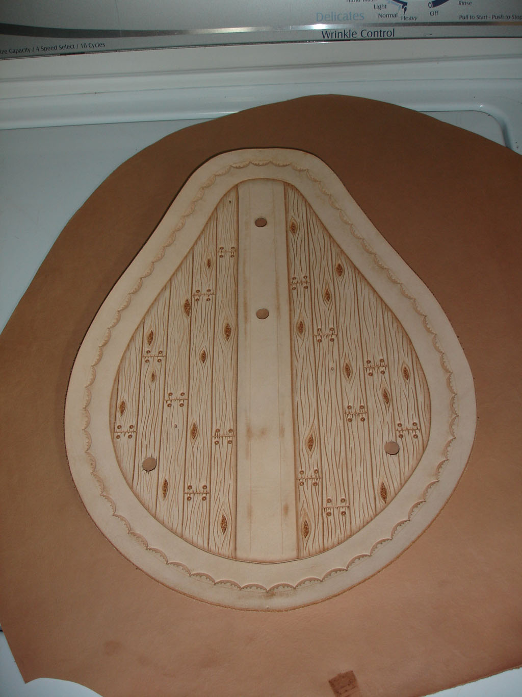

Here's a few pics to study... hope they help...
Troy
DSC00010 (2).JPGDSC00012.JPGDSC00013.JPGDSC00014.JPGDSC00016.JPGDSC000055.JPGDSC000056.JPGDSC000079.JPGDSC000086.JPG
Troy
Troy
post-6344-126191559724_thumb.jpgpost-6344-126191559831_thumb.jpgpost-6344-126191559932_thumb.jpgpost-6344-126191560045_thumb.jpgpost-6344-126191560155_thumb.jpgpost-6344-126191560261_thumb.jpgpost-6344-12619156039_thumb.jpgpost-6344-126191560509_thumb.jpgpost-6344-126191560619_thumb.jpg
very nice wood grain
Calvin Deeds

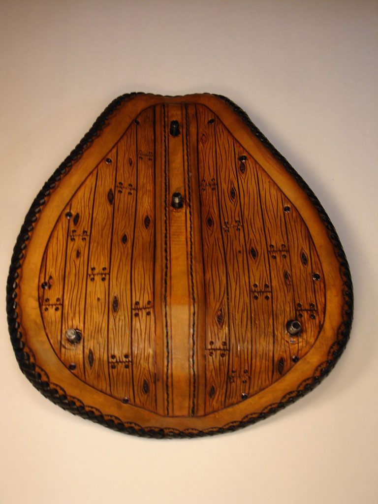

Here's a pic of the entire seat... let me know what ya think...
post-6344-091905100 1295866965_thumb.jpg post-6344-043627500 1295866981_thumb.jpg post-6344-075060600 1295867022_thumb.jpg
Troy
That seat is very cool! I like it allot!!!!!!!!
