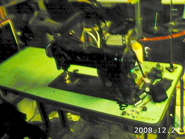

Im putting 7-8 oz wear leathers on about an 1" thick pad with a older walking foot singer with no problem. its a tight fit but it smooshes down just fine your toro shouldnt have to much problem doing it. good luck. Bronc/Bonnie
