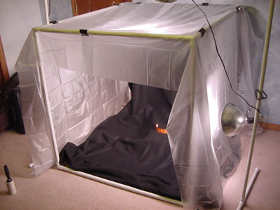

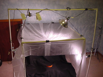

CitizenKate Report post Posted January 13, 2008 Here are some photos of a large soft box I made from PVC pipe and 2 translucent shower curtains. I also made a lamp stand that arches over the soft box of PVC pipe. Someone else posted an nteresting design for smaller items... if they don't repost, just sit tight and it will (probably) be restored from the past in the near future. Kate Quote Share this post Link to post Share on other sites
