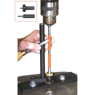

On another note, here are some pictures of some older slickers that I have and the new one that I made. I had the older ones made before I bought a Mercury Mini lathe. When I made mine I downsized the slicker, inserted a lag bolt (3" - it is in the material about 2-1/4") for the shaft and reduced the number of slots...just my personal preference from using these others over time. The chuck does chew up the wooden shaft over time and has to be lightly turned down or as you can see one one of them has a copper sleeve. As I said the new one uses a 3/8" lag bolt that is Gorilla glued in. It has had lots of use with no ill effects.

This looks very interesting and perfect for my needs, though I'd have to move my drill press to a different location because of the wood shavings. I'd like to know how the turning blank is secured on the mandrel. I'll see if I can call them.

I'm liking the idea of this drill press lathe more and more. I could cut down the raw turning sticks to sizes needed and turn just those sections, which fall within the range of 3/4" to 4".
One chisel I know I need to get is a 1" rough out to knock off the angles of the blanks. I'll need another chisel for creating the channels. For these channels, would it be best to get spindle chisels of varying widths of 1/4", 3/8", 1/2", and 1", or would a 1/4" spindle chisel allow for a channel width of 1/4" to whatever is desired, depending on how you run the tip along the dowel?
Another question: My drill press currently has the belt set on the middle pulleys for @ 1725 rpm. If I want to change the speed, do I need a different belt, or do I just position the same belt on a different set of pulleys?

The same belt works. You will notice that there are a number of stepped pulleys on the motor and on the quill side. Most of the time when you raise the top the manufacturer will have a diagram of pulleys/speeds.
My son used this setup for a while. He used it with some success and you have to make sure that you have the chisel adjusted correctly. Generally a chisel cuts above the center line and a scraper goes below the center line.
If you are set on particular sizes then I would make some scrapers of the size you want but if you are only going to be doing a limited number of cuts then the smallest size chisel will cut all the smaller ones by moving the tool back and forth. I would suggest cutting yourself a template to check against so that you know how much to take off or use calipers if you have them.

Ed I forgot to add that I just buy square blanks and draw a line from corner to corner. I drill down at the "X" and then horse rasp the corners off before turning it down. I glue a drill blank in to the wood with two part epoxy. I have been getting the drill blanks from Grainger's.com But I think even the hardware section at Home depot has them. I must admit that for the last one I didn't have a drill blank so I glued the drill I used to make the hole into the slicker. It needed sharpening or replacing anyway. hahaha
