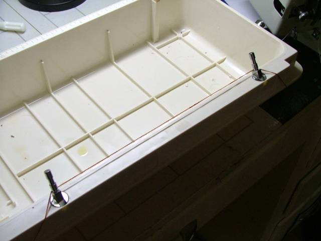

Hi ,Iam Putting My New 206 Consew Together.There A 2 Pins That Are Driving Me Nuts.Every Time I try To set The Machine In Its Case The Pins Fall Down.Can Someone Tell Me Their Purpose Is?Iam Making Progress This On This Consew..Once I start Sewing,Iam Confident That I Will Like It.Can I Use 138 On Top And 69 On The Bottom?I Sew Hunting Bags,Ball Bags,Bible Covers,Check Books,And Other Small Things.Mostly I use 5/6oz. Sometimes I use 8/9 oz. Veg Tan For The Ball Bags.I Just Put In My First Order To The Springfield Leather Co.And Iam Impressed So Far.Thanks,Navy
Iam adding a picture to the previous topic.Navy

Those pins go into the backside of the head and allow you to pivot the machine back to get at the underside. I can't see them that well, but it looks like they might be in backwards. The pins should be able to lay flat toward the inside of the pan. For some, it is a little easier to put the pins in the head then vertically set the head into place, that way, they won't fall out.
Art

Thanks very much,that clears it up for me.Navy
