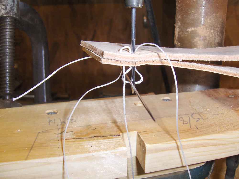

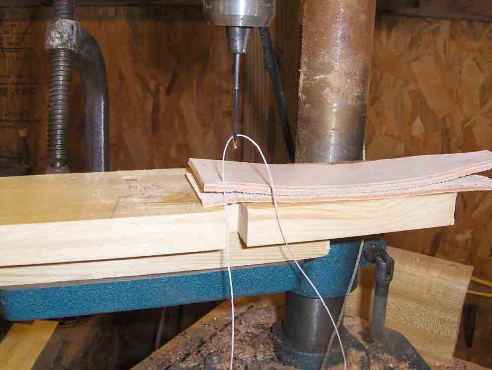

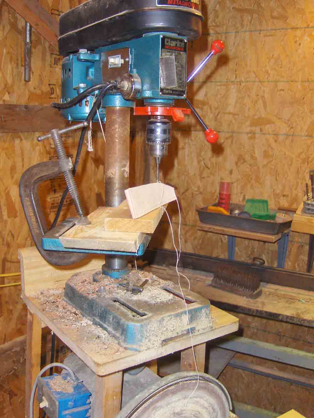

I don't remember who it was that asked for pictures, . . . here they are:
It may sound problematic, . . . and may look hokey, . . . but my fingers and wrists are beyond hand stitching. I had to figure out another way, . . . and it makes a stitch that is equal to my Tippmann, . . . and of course, . . . if I want to, . . . I can do designs on the face of the leather, . . . sorta like embroidering.
Anyway, . . . just another tool for those who need it.
