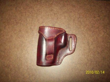

My cross draw.jpgHere is one I made for myself. It is my second holster so it isn't the prettiest, but is functional. Hope these pics will helpMy Cross draw back.jpg
