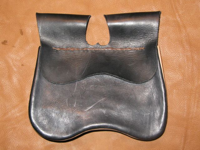

Front. No strap or buckle yet because I don't have an appropriate buckle right now.

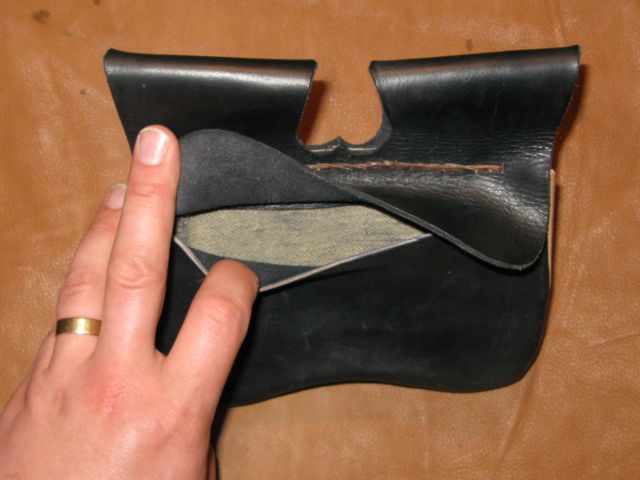

Access to the front compartment under the small flap. The rear of the compartment is textile as per the originals. I used a bit of linen canvas, which is a bit too heavy. Next time I'll use some heavy apron weight stuff.

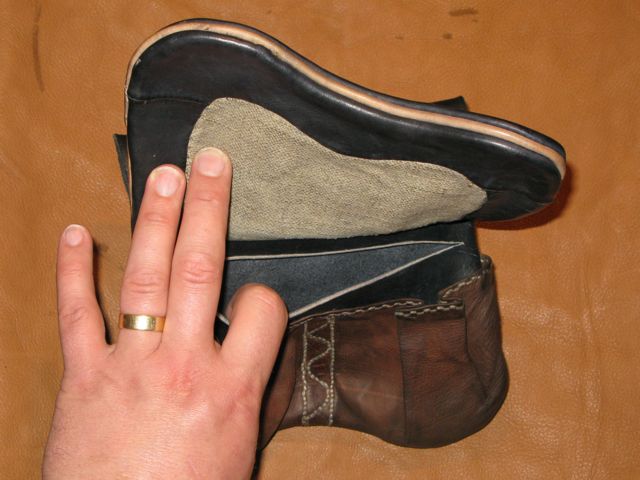

Lifting the front compartment shows the pouchlets on the front of the back compartment. The leather reinforcing around the edge of the linen is whip stitched on the inside so the sewing doesn't show.

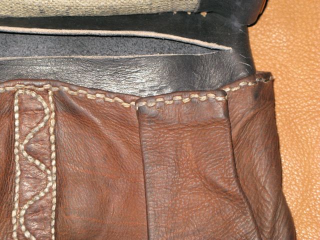

Looking down into the pouchlets. You can also see the folded welt in the front compartment here. It adds a bit of decoration and a little bit more internal volume to the compartment. There are no gussets in this style of purse.
Side view showing the folded welt and the way the leather for the pouchlets is sewn into the side seam before the purse compartment is turned.
Decorative stitching on the pouchlets. I only got this right on one of them but the alternating stitch decoration on the edge is done by controlling the lay of the threads in the stitch not by moving the awl holes.
