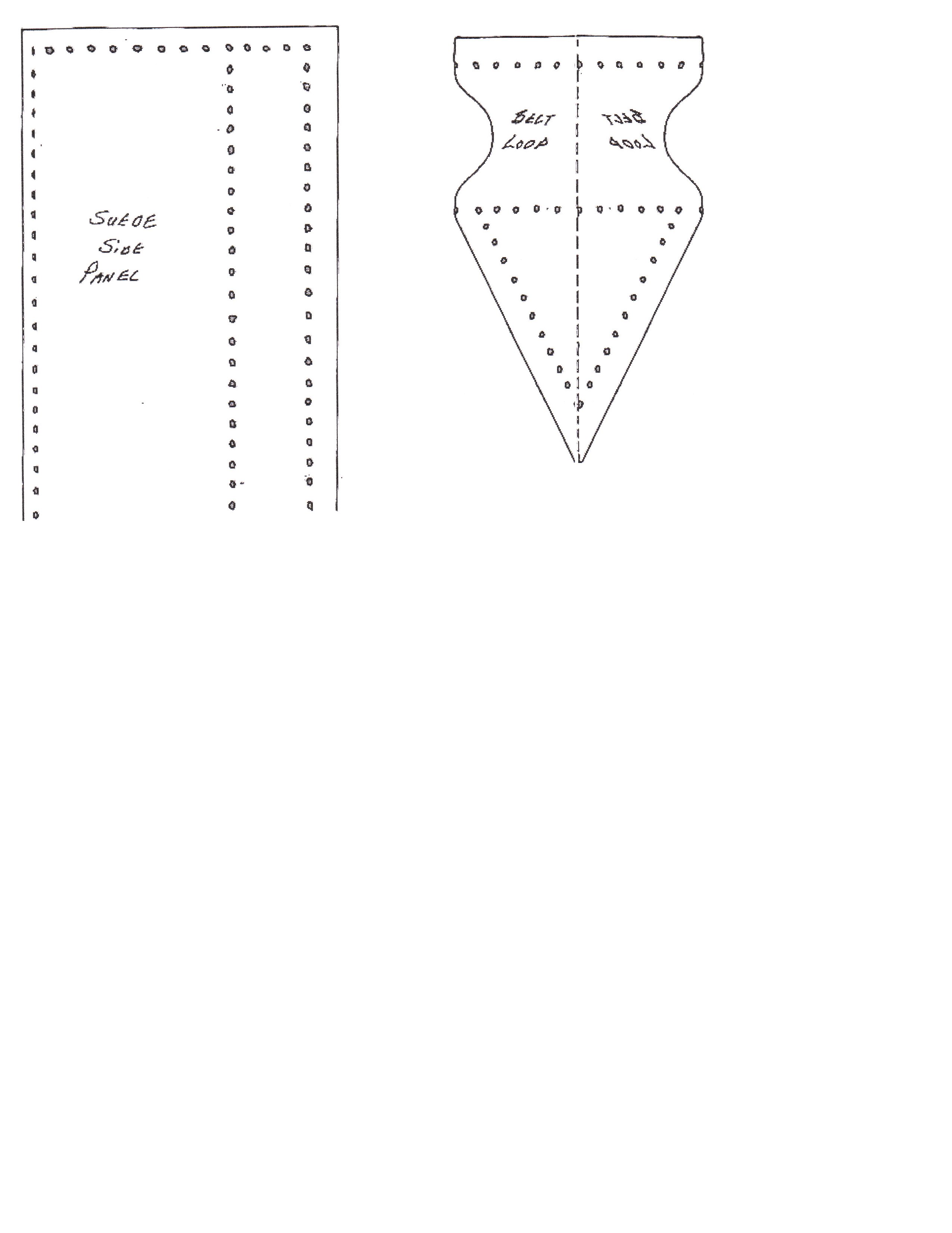

Interesting you should ask about sporrans. I don't have a pattern, but I do have my grandfather's sporran from WWI. He went to France with the Canadian 42nd Highlanders, a regiment of the Black Watch. I've been thinking of making one similar to his, as it is very cool looking. Here is a picture of him wearing it.
291sporr.pdf
There was one in the leather crafter saddler journal. I have this one also but can not post here.
291sporr.pdf

I have made the sporran in the PDF above, and while the pattern works, it does give a substandard looking sporran IMHO. I have made a new pattern which I will post when I get a chance, for anyone who may want one. The protype I made is better looking, and more correct to the 18th century, yet still looks great and fits in the 21st century.

Here is the sporran and some pictures of the templates I used. Measures about 7 1/2 inches by 8 1/2 inches. The toggle is just a small piece of branch, I had lying around, split down the middle and sanded on the back. The front "bellows" out to allow the hand inside. Squares are 1/4".
Mark
Mark
That's a great looking rob-roy style of sporran. What weight and type of leather did you use for it? Thanks for posting the pattern.

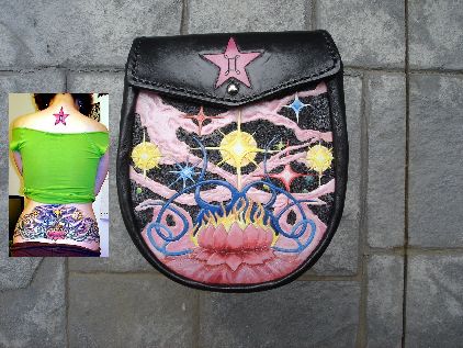

Here's a sporran pattern I used for my first go at one. The pattern is from the May-June '93 Leather Crafter's Journal. I did a bit of non-traditional carving on it, to match my friend's tattoos. But the pattern itself is traditional enough.
I joined the front and back with a 2 3/4" strip of garment leather and lined the whole thing in pigskin suede.
