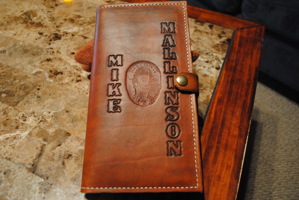

The ticket books that I have been making lately are made from light skirting. Yes it's a little heavy, but the officers love them. They have their names and their badge (thanks to Jeff at Grey Ghost Graphics) on them. I have a set price and anything extra, costs extra (such as tooling and designs). The badge is a little hard to see. I have a 4 ton press that I have to use to get a good impression of the badge, but due to the size and detail of the badge stamp, it doesn't show real good. The books have an inside pocket on each side of the book. Inside the pockets is a 1/8" board (cut up notebook from the dollar store). This gives the firmness that I and the others needed for the citation book. As far as writing the citation, they have to use the cardboard that came with the citation book itself or some of them get a very thin piece of aluminum or plexiglass. Haven't heard any complaints on that yet. I only have pics of the ticket book closed. If you need to see the inside, let me know and I will post a pic. Sorry the pics aren't the greatest.
