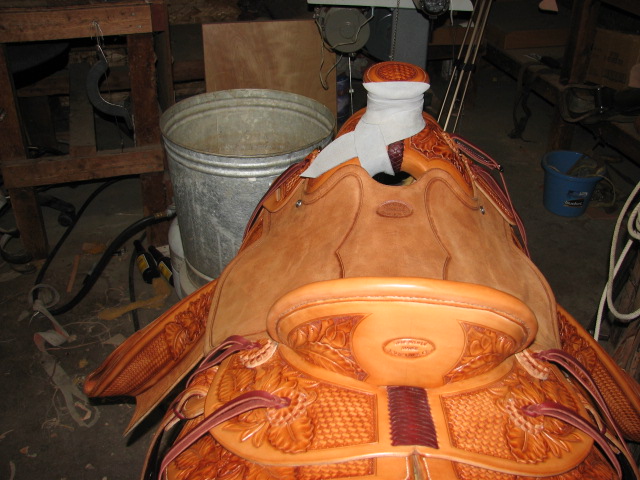

Just finished this saddle,It has a 16" seat,9" swell,5 x 10.5" cantle,wood post horn 3" high X 3 3/4 cap.The seat and fenders are ruff out ,the rest is Basket stamped with floral corners.7/8s flate plate rigged.Spec 1 001.jpgSpec 1 004.jpgSpec 1 002.jpgSpec 1 003.jpg

What do you use for the parallel lines on the seat? I have a single crease and the lousy one(adjustable) that Tandy sells. It has a screw on the side but the edges are different thicknesses and is sort of made for an edge crease if anything.
Do you have a double creaser, who makes it and do you have to go back and bevel each side/does it cut or just scribe the lines?
thanks
pete

Pete,I use a beader that McMillen made me 38 yrs. ago.It just creases the double lines into the leather.Saddle is sold,shipped it to Montana last week
