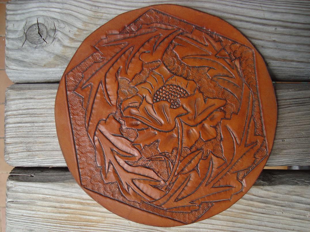

Thanks for your advices. In order to illustrate what I said about my work, here are some examples of what I do.
There are a lot of little tricks to get depth, but the first and one of the most basic is to work half way through the leather thickness you have. Start by cutting half way through with the swivel knife. Then bevel, shade, background, etc. down to that depth.

I think one of the keys to getting a 3-D look to your work is to learn to vary the depth of your cuts and your tooling. Take your leaf for example. It looks like you have cut and beveled the center vein the same depth as the border of the leaf. By tooling it to that depth, it makes the vein look like it is setting on top of the leaf instead of being a part of the leaf. If you would have cut the center vein shallower, then beveled it lightly, it would give it a more realistic appearance, IMO.
A really good place to go for basic tooling information is Paul Burnett's Painting Cow website. Check out the free lessons he offers. There is a LOT of info there to get you off on the right track.

Thanks a lot for all these advises that I will try to apply.
I concur with the others(I'm still learning) proper casing, swivel knife depth. And don't be afraid to whack a little harder with your choice of whacking instruments. Also once your getting your main depth of your object, then as your adding your detail work will be where I'll start backing off with the maul to give it some depth-3D. One more thing I'm sure you'll read elsewhere is the 3 p's-Practice, Practice, Practice.
