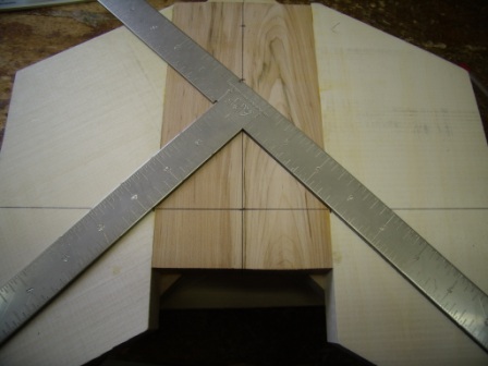

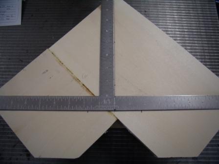

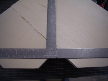

Rod and Denise Nikkel Posted April 22, 2008 Report Posted April 22, 2008 This is a precision tool made out of stainless steel used for precise, symmetrical layouts. It is made so that using a 0.5 mm mechanical pencil straight up and down will make your marks precisely where you want them in relationship to the markings on the square. You can start with the square and not only have a perfectly square T, but mark precise distances on either side of the vertical, and up the vertical with just one measurement. It can be used to make a line totally perpendicular to one you already have laid out, and mark precise distances on either side of the vertical line. The 90 degree square is square and can be used to make precise 90 degree angles using the 1/16” markings to get it perfectly lined up. With this square you don’t need the center to be present to know you have your marks even on both sides. I am looking both to see if there is much of a market for this, since it doesn’t seem that such a tool exists. Other than saddle tree makers, do any of you know of a situation where this type of tool would be well used? Do any of you want such a tool for your own use? Back before the crash I asked a similar question and Regis was able to connect me with his son at American Precision Fabricators who made me a beautiful prototype. He is now willing to make a few of these if anyone wants them. Cost will depend a bit on how many I order due to the shipping, but will probably be in the $70.00 US range (these are precision made) plus shipping. If anyone is interested, please PM me. Quote "Every tree maker does things differently." www.rodnikkel.com

Contributing Member Denise Posted April 22, 2008 Contributing Member Report Posted April 22, 2008 If I were to design it for myself, I would have a dropped foot with numbering on both sides so I could flip it over for applications where I didn't want the foot. Showing my ignorance here, but that's OK. I have lots of that. Can you explain what you mean by "dropped foot"? By the way, this one is 18" long and 9 1/2" tall. Thanks, Denise Quote
Moderator Art Posted April 23, 2008 Moderator Report Posted April 23, 2008 Hi Denise, The bottom portion of the "T" is thicker and allows it to easily bear against the edge while the perpendicular portion lays flat on the surface, however the top of the perpendicular and "T" are flush, so you can flip it over and use it as a square on a flat surface. Art Showing my ignorance here, but that's OK. I have lots of that. Can you explain what you mean by "dropped foot"? By the way, this one is 18" long and 9 1/2" tall. Thanks, Denise Quote For heaven's sakes pilgrim, make yourself a strop!

Contributing Member Denise Posted April 23, 2008 Contributing Member Report Posted April 23, 2008 Hi Denise,The bottom portion of the "T" is thicker and allows it to easily bear against the edge while the perpendicular portion lays flat on the surface, however the top of the perpendicular and "T" are flush, so you can flip it over and use it as a square on a flat surface. Art Ah, I get it. I don't need that feature for any of the work I do so hadn't thought of it. All the T squares out there have that, but on both sides so they will never lay flat and that makes them useless for me. The disadvantage would be that you would then have to have the markings on both front and back of the square, and it is putting exact measurements on that is costly. Need to think about this more... Thanks Art! Ed, try a center finding rule and see if it is good enough. If not, let me know. Denise Quote
