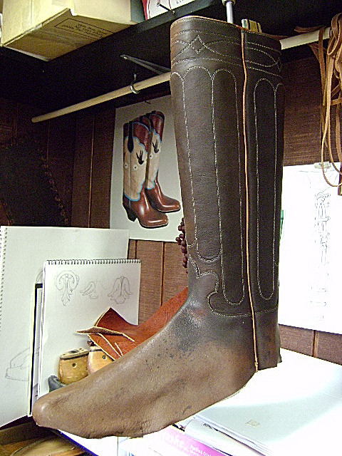

I've attached a picture of a fitters model of the western boots I make. (It's the assembled rough outs)
They are made up of remnant leather, assembled so as to give me the negative space for the last to fill. I usually make them to test the fit before I begin making the boots, but also sometimes as a pattern test.
If you wanted to practice toe boxes, you could properly install remant leather liners (I guess that would be good practice too), and pull it over your last.

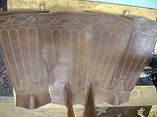

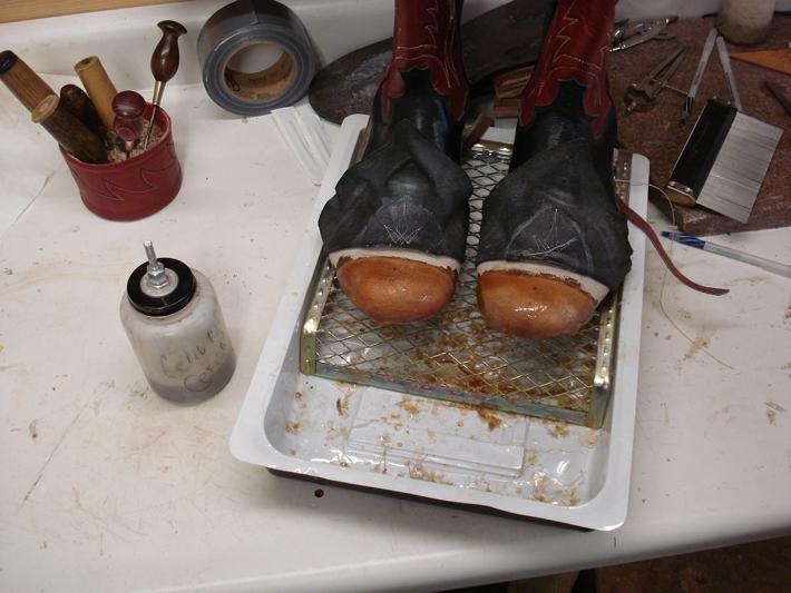

I've looked thru most all the pictures on my computer, and I don't see any for lasting as instructional images.
The best I can do is the next three attached.
They are;
1. tops and vamps are ready to be side seamed,post-8631-036089400%201285876415_thumb.jpg
2.treed prior to being lasted, andpost-8631-007047000%201285876422_thumb.jpg
3.lasted.post-8631-068138600%201285876428_thumb.jpg...
everything but the actual lasting..

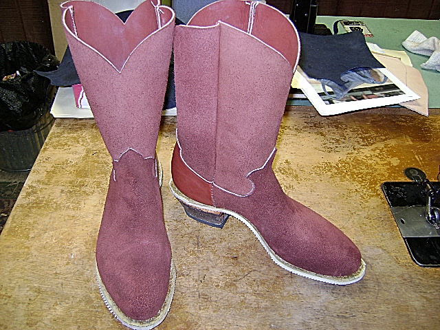

We can do that in it's turn. But I've attached a picture just to feed your imaginings. This is for a box toe, one that is squared across the front by a turn up on the insole. it's not really what you're likely to do, but it's the picture I have of the sculpted insole at this stage.
