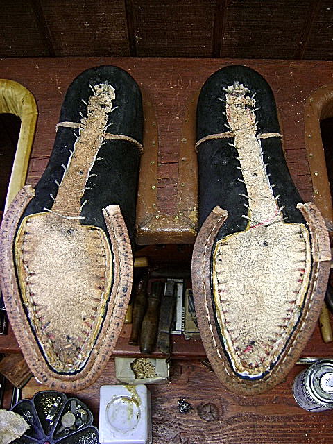

Members sepulverture Posted December 10, 2010 Author Members Report Posted December 10, 2010 Here is an update on my boots. I have mostly stitched together one boot, minus the backstrap, closing the quarters and one of the facings. I am also having a bit of trouble deciding how to make the lining. I am thinking two halves, a forepart and counter/quarter sewn together in the middle and doing making a pocket for the counter stiffener and closing at the top with something like a bead made of softer brown leather. Here are progress photos Quote
Members Leatherimages Posted December 10, 2010 Members Report Posted December 10, 2010 Hey, it's starting to look like a boot! Great! The hand stitching gives it an interesting look, but the holes will let dust in very easy. I'd say if you're think a two piece liner, you should go that way. Maybe stitch inverted seam with "right sides together". What were you thinking for a tongue? Quote Back to the bench, Paul "When you finally get your wings, don't complain about the wind in your face."
Members sepulverture Posted December 11, 2010 Author Members Report Posted December 11, 2010 Hey Paul, thanks for the compliments! The stitch holes that are visible are actually only exterior holes. Since all of them are seams I only punched holes with the puncher on the outer layers of leather. The portions of the seams that are not visible (the under layers) are punched with a waxed awl to help keep out water and dust. Not perfect of course, but ought to help. Additionally I am going over all the seams on the inside with a sealant like silicon caulking or something along those lines. As for the liner I'm not exactly sure what is meant by an inverted seam, but I think I have an idea. Would you care to explain it for me though, just to be sure? As for the tongue I am thinking about a simple full-bellows tongue. Comfortable, and better water-proofing/wind-proofing. Quote
Members Leatherimages Posted December 11, 2010 Members Report Posted December 11, 2010 I like the idea of a sealant behind the holes. A band of 1 1/2 to 2 ounce leather, skived along the edges, and glued in place would work also. An inverted seam involves a seam allowance (say about 5mm) skived and stitched right sides together. Spread the seam allowance, glue it down, and press flat. A bellows tongue is a good idea, but challenging. I've done a few. But you sure aren't afraid of challenges. Good on you. Quote Back to the bench, Paul "When you finally get your wings, don't complain about the wind in your face."

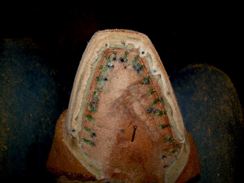

Members sepulverture Posted December 30, 2010 Author Members Report Posted December 30, 2010 Good news! First boot is done! Everything turned out quite well with the exception of the area around the welt. When I sculpted the holdfast I sculpted part of it wrong, so the welt didn't sit securely under the holdfast. When I sewed on the welt it sat good and tight against he side of the last on the vamp, but when I turned it down it did tear out a little bit as expected. It's not terrible though, and it's not really noticeable. I am concerned that he vamp will tear out, but not expecting it to for a fair while. Anyway, here are some pictures of the fist boot and the second one is well on it's way. Quote
Members Leatherimages Posted December 31, 2010 Members Report Posted December 31, 2010 Nick, A very respectable job. I'm eager to see the mate. Your next pair will be a completely different experience. Keep up he good work. And Happy New Year From Stateside! Quote Back to the bench, Paul "When you finally get your wings, don't complain about the wind in your face."

Members Leatherimages Posted January 2, 2011 Members Report Posted January 2, 2011 I like your perspective. I like your whole attitude toward learning, I think you could be a great shoe/boot maker. You're on your way. Your thinking is good for a repair to a breakout like that. You can also (with your insole probably tempered) back up 1/4" and come at it from a little deeper. A sharp, polished, inseaming awl, with it's bigger curve than a stitching awl, gives the job a better chance. I was shown to place my inseaming awl into my channel convex curve rather than concave, if you know what I mean. Point down, enter and twist, coming out at the base of the holdfast. The more consistent you are, in making the hole, the better the stitch line will be clean and straight. Allowing, that is, the thread to awl sizes are compatible. There's a chart or something in the Colloquy archives, but the important thing is to use what you have a practice good technique while you look for better tools. It's aprocess. Show the pair when you're done. Happy New Year! Quote Back to the bench, Paul "When you finally get your wings, don't complain about the wind in your face."
