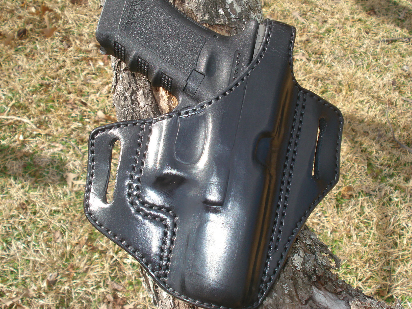

Hey BanjoMan,
I use the USMC Black, it's a spirit dye. I dye with a dark color, blue or green first (in the attached photo it was dyed green first), then apply the black over it, usually two coats, then let dry for a day or so. Then I oil with neatsfoot oil and let dry for a day or so. Then apply acrylic resolene, cut 50/50 with water. Gives a nice satin finish. Follow up with black leather balm with atom wax and you should be in good shape.
That's just my way. There are others who are more qualified than me who might have a different take.
Good luck,
Dave
post-14241-007101900 1294605421_thumb.jp

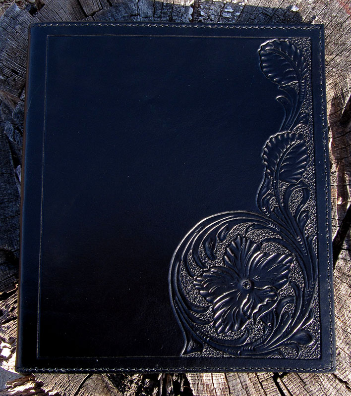

Thanks everyone for the replies and the good advice! Sorry it's taken me so long to get back, I've been busy.... Since starting this topic, I have obtained several colors of Fiebing's oil dye, Fiebing's resolene, bag-kote, tan-kote, and other products. I knew as soon as I touched the dauber to the leather, Fiebing's black oil dye is in a whole different league compared to the Eco-Flo. Seems to me that the Eco-Flo acts more as a stain instead of a dye, requiring several coats before showing results. So after solving my problem with the dye, I ran into the question of what finish to use? Keep in mind, I want LITTLE to NO gloss! I tried the resolene and immediately noticed that it produced more of a gloss than I preferred. It may have to do with the fact that I applied it full strength with a damp sponge....just gonna take some practice I guess. I then took the advice of many and applied a coat of Kiwi neutral shoe polish and it helped cut the shine somewhat. I would like to try a different sealer and am considering using either tan-kote or bag-kote, but am having problems finding someone who knows what the difference is between the two. Even the people at Fiebing's could not give me a definite answer! At this point, I think I'll just finish several sample pieces with different products until I discover what gives me a desired result. In conclusion, Fiebing's oil dye (black and other colors as well) is AWESOME! Below is a picture of the project I just completed using (in order): Fiebing's black pro oil dye, neatsfoot oil, resolene, bag-kote, and kiwi neutral shoe polish. Hope you like it!
