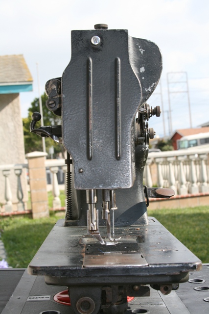

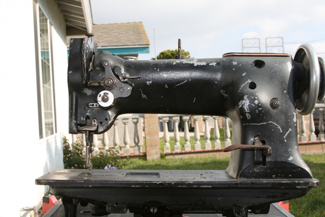

JRodz Posted January 9, 2011 Report Posted January 9, 2011 I need help identifying this machine. I was told it was a Singer 11W155, but the pictures I have seen of 11W series do not have the lever in the front. All parts are stamped with "Symanco USA" so I don't think it is a knock off. Any help would be appreciated. Also, this probably needs to be a seperate post but I would like to hear some imput on whether a speed reducer and servo motor would work well with this machine to get it to where I can use it on small projects. Right now it's got more pick up than my old Chevy truck and it has a built 350. Too difficult to use with the clutch motor since I am not experienced in sewing. Quote Jose Rodriguez SoCal Leather Co.
Moderator Wizcrafts Posted January 9, 2011 Moderator Report Posted January 9, 2011 That is a Singer 111w155 walking foot machine. It is probably 50 to 60 years old. If it is in good working condition (not too much slack, well oiled, no junk in bobbin case, no stripped parts), it should be able to sew up to 5/16" of medium temper leather, or a pair of jeans, or sailcloth. The maximum thread size is typically #138, sewn using a #22 needle. The needle system is 135x17, or 135x16 (leather). Get a servo motor from Raphael Sewing/Techsew, in Montreal, and you'll be good to go. Better yet, take it to them and have them go over it and adjust and oil it for you, replacing any really worn parts. If you take the table with they can install the servo motor for you. If you want to do all this yourself, you are on your own. Quote Posted IMHO, by Wiz My current crop of sewing machines: Cowboy CB4500, Singer 107w3, Singer 139w109, Singer 168G101, Singer 29k71, Singer 31-15, Singer 111w103, Singer 211G156, Adler 30-7 on power stand, Techsew 2700, Fortuna power skiver and a Pfaff 4 thread 2 needle serger.

Members Gregg From Keystone Sewing Posted January 13, 2011 Members Report Posted January 13, 2011 Machine is NOT a 111W155; this model never had a reverse/back tack. It's a 111W156, quite a rare bird not many people know about, seen here; Singer 111W156 Quote Industrial sewing and cutting, parts sales and service, family owned since 1977, Philadelphia, Pennsylvania USA, 215/922.6900 info@keysew.com www.keysew.com
JRodz Posted January 14, 2011 Author Report Posted January 14, 2011 Thanks Gregg, I new there had to be more to this story since it never matched any pictures of any Singer 111W??? I had ever seen. Quote Jose Rodriguez SoCal Leather Co.
Members Gregg From Keystone Sewing Posted January 14, 2011 Members Report Posted January 14, 2011 Thanks Gregg, I new there had to be more to this story since it never matched any pictures of any Singer 111W??? I had ever seen. Nice, glad to help. It's certainly a rare model, not many are even aware this model was even made. Quote Industrial sewing and cutting, parts sales and service, family owned since 1977, Philadelphia, Pennsylvania USA, 215/922.6900 info@keysew.com www.keysew.com
