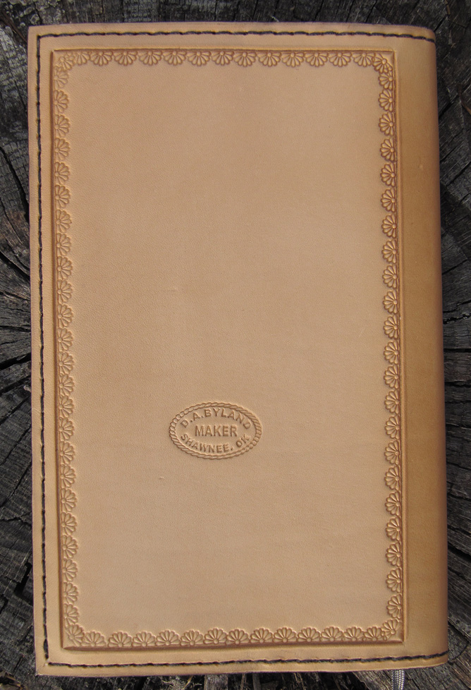

bison Posted January 28, 2011 Report Posted January 28, 2011 I make my covers similar to Pete's. I measure the book closed with a cloth measuring tape from front cover edge, around the spine to the back cover front edge. I then make a template out of heavy board (I use Mat board from Hobby lobby). I add 3/4 inch to the measurement around the book and the same for the measurement top to bottom (3/8 inch per side). Don't be afraid to add more...you can always trim it..in fact, I usually add more if it is a size I haven't done before. I place the template on the leather-7/8 oz, scribe it then cut it. Flip the leather over for the rough side and find the center line top to bottom. Measure the spine of the book and add about 1/4 inch. Divide that measurement in two and measure that distance to the right and left of the center line. Gouge those two lines with a V-gouge about 1/2 way through the leather. I do this by laying a straight edge on the leather and running my gouge along the line against the straight edge. I then skive out the middle with a French Skivver. This helps ensure the leather will bend and not crack, and that it will stay closed when it's on the book. I then tool the cover, front and back, stain, oil, edge. Then I use a thin leather, 2-3 ounce to make the inside flaps that will hold the cover of the book. I rough cut them about 1/2 larger on three sides, but make sure I have a nice straight cut for the inside of the piece. I place the cover on the flap, rough to rough and outline the cover on the flap. I remove the cover, put contact cement on the cover covering about 1/8 inch from the edge in on the area the flap will cover. I put contact cement on the flap the same way, using the line I drew as a guide. When they're ready, I put them together and make sure the bond is good and tight. Then trim the flap on the top, bottom and outside edge. I don't always dye the flaps, but if I do, I do it before I attach it to the cover. After trimming, bevel the flap edges, then burnish and seal. Then grove and stitch mark the cover if you haven't already...I usually do mine before it's dry from tooling. Punch or drill the holes and stitch. Put the cover on the book and enjoy! As to tooling pattern, I'm not the guy. I use patterns I purchase mostly or cut and paste. Just started making my own. I've attached a photo of a cover I made for my wife for Christmas. She likes it! Good luck, Dave Quote
