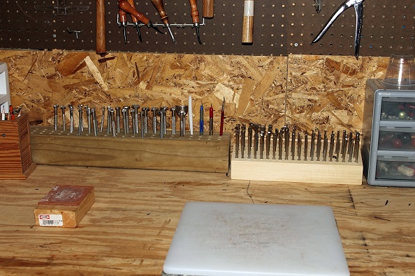

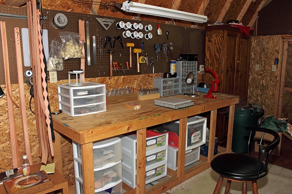

The first two are pictures of my old shop that was in my basement, the last two are of my new shop with lot's more room and better layout.

Yeah, I would say your new shop has a little bit more room. It looks nice! How deep are your work tables?

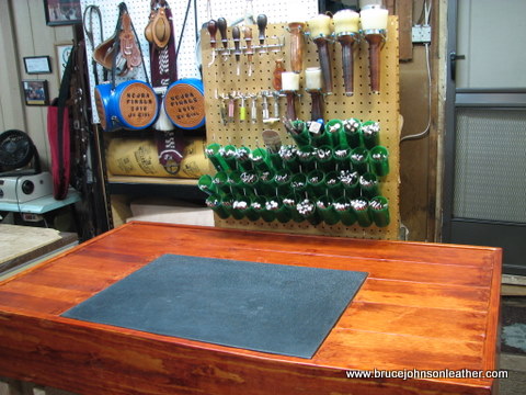

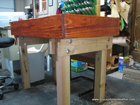

Here is my new stamping bench. I built it last summer after seeing several different types and sizes of benches in other shops and advice from guys on the forum here. It is 48" wide to hold longer things like belts and saddle skirts. It is 29" deep so I can easily reach the stamps. The height is 37-3/4 so I can stand or sit on a drafting chair. The rock is a granite insepction plate from Grizzly that is 24x18. I like the larger rock for less noise, bounce, and a bigger area to beat on.
