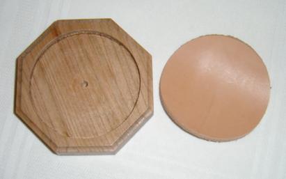

I want it to cut coasters.
My carving isn't that great, I'm still learning but slowly improving .
I wonder if the rotary tool wood be better for leather?

Thanks for the tip, I'm going to try a few things until I find something that works.
Thin wall pipe might be the answer, even better if it works on an arbor press.
I have a hole saw coming that I'll put on the drill press, the leather is glued to a board and the board is held by clamps.
My only concern is some minimal wobble without the drill bit in the center but we'll see what happens.
Another idea is gluing the leather to a round wooden disc and trim it on the router table using a bearing guide on the wood.
Thanks again,
Kevin.

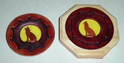

Just to let you folks know, the Lion Ev-R-Round works great for cutting clean circles in this 8oz. leather.
post-19342-067103100 1300576726_thumb.jp
We're spit'n out coasters now! :spoton:
post-19342-065141600 1300761218_thumb.jp
specool.gifThat is nice tooling. Glad that you found the right circle cutter.
