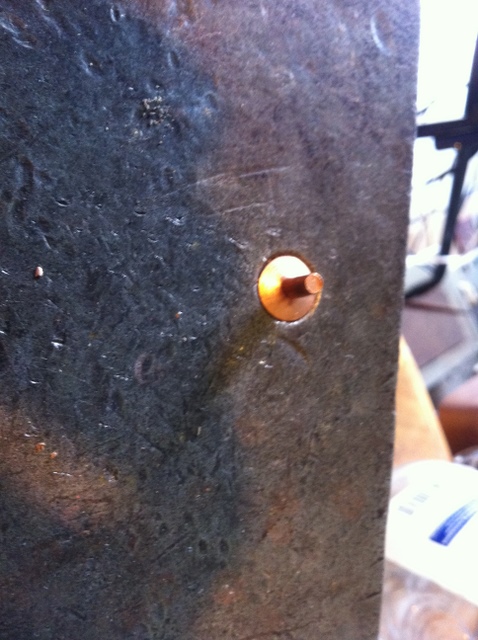

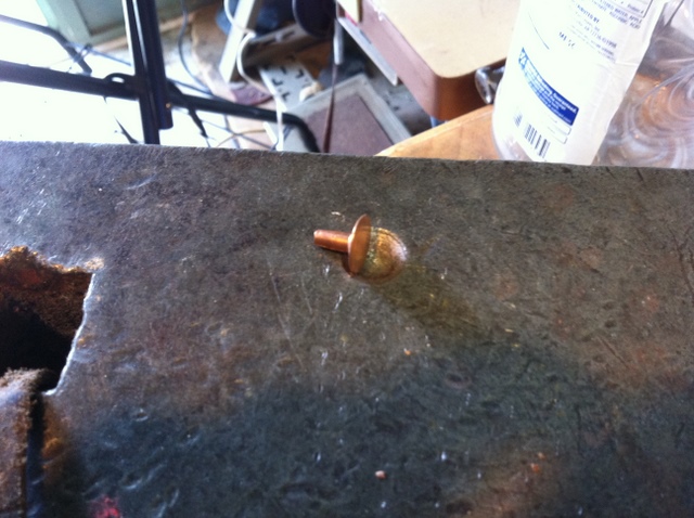

post-13207-010313100 1302108280_thumb.jppost-13207-077853600 1302108269_thumb.jppost-13207-094012800 1302108258_thumb.jppost-13207-023612700 1302108250_thumb.jppost-13207-092478100 1302108241_thumb.jp post-13207-023547600 1302108233_thumb.jp I have a pretty good method that works. I dome the rivet before I use it. I have drilled an impression into my anvil, then I put the rivet head into it and slide something slightly larger than the rivet shaft to force the head down into the hole. Works great everytime. Edited by seveneves
