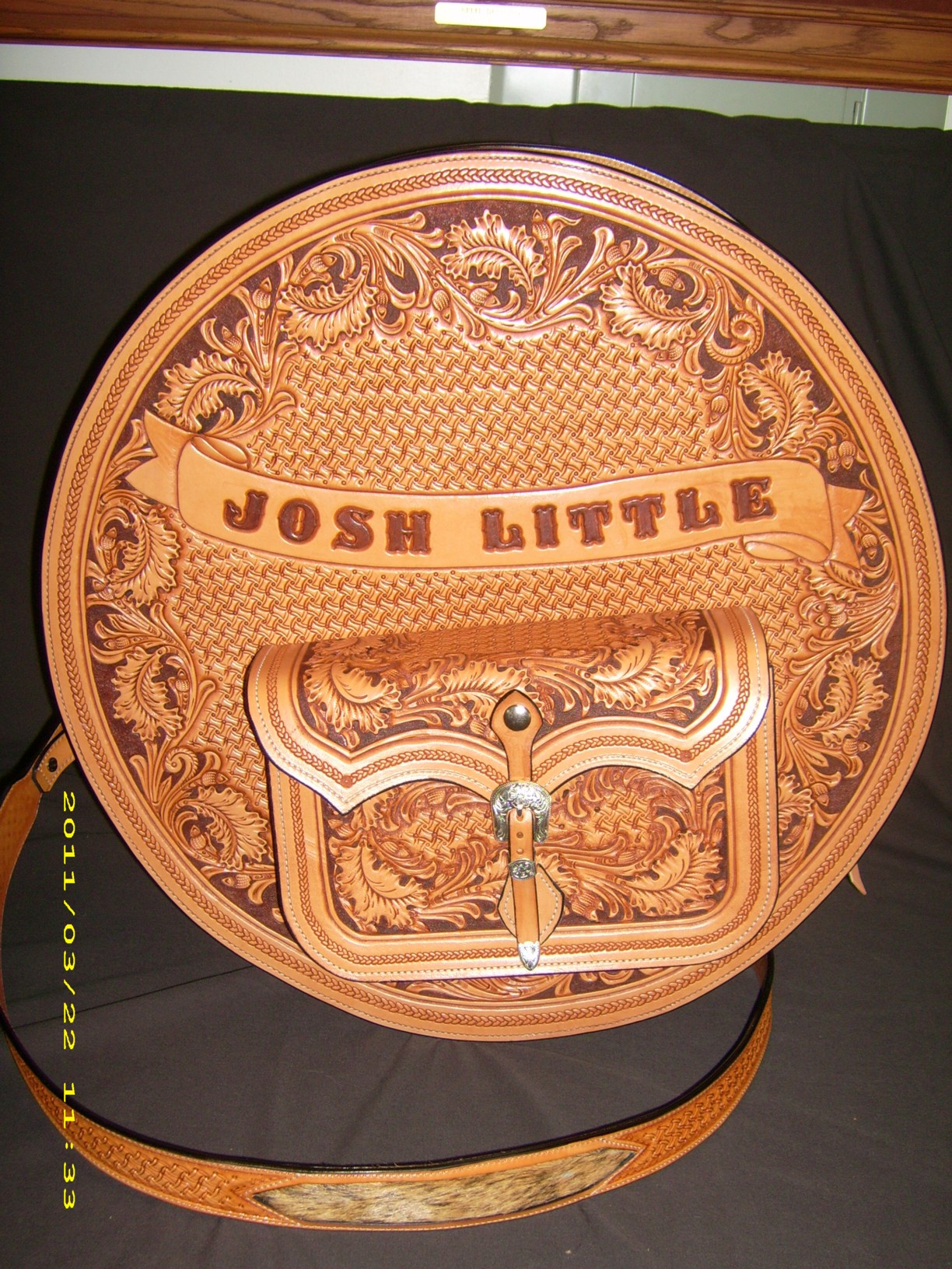

Members leathercrafter Posted March 29, 2011 Members Report Posted March 29, 2011 I have never been able to inspect either of these items up close, but want to learn to make a rope bag (for headers and healers) and rope cans. I know that rope cans typically use the plastic rope cans you can buy, but then how much of them end up covered with tooled leather? Just the sides? any of the insides? Then the larger challenge, a rope bag with two sides, one for heading ropes and one for healing ropes. There are no patterns I can find for these, and I have only been able to inspect a few, not enough to go home and make one. Can anyone share a pattern and instructions on how to make one? Any information would be so grateful. I haven't been able to find much information about these items in books, and haven't seen many in my neck of the woods (Western Oregon), so I don't get much of a chance to study them up close and personal, but REALLY want to make them one of my next projects. thank you all Charlene i have done several rope bags some with single zippers some with double zippers and deviders. i have inclosed one that i just finished if you want to call me i would be happy to answer any questions i can for you hope this helps Quote when it comes to helping others always remember someone helped you once[feel free to visit my galleryEmail me

Members leathercrafter Posted April 4, 2011 Members Report Posted April 4, 2011 Hi.... I am also interested in making one!! Are your rope bags a complete circle or is it a slight oval?? Thanks Gypsy Leather all my rope bags are round they have a pocket on the side for powder and gloves, most have a double zipper and a divider in the center hope this helps let me know if i can be of any more help john Quote when it comes to helping others always remember someone helped you once[feel free to visit my galleryEmail me

Members leathercrafter Posted April 21, 2011 Members Report Posted April 21, 2011 I have never been able to inspect either of these items up close, but want to learn to make a rope bag (for headers and healers) and rope cans. I know that rope cans typically use the plastic rope cans you can buy, but then how much of them end up covered with tooled leather? Just the sides? any of the insides? Then the larger challenge, a rope bag with two sides, one for heading ropes and one for healing ropes. There are no patterns I can find for these, and I have only been able to inspect a few, not enough to go home and make one. Can anyone share a pattern and instructions on how to make one? Any information would be so grateful. I haven't been able to find much information about these items in books, and haven't seen many in my neck of the woods (Western Oregon), so I don't get much of a chance to study them up close and personal, but REALLY want to make them one of my next projects. thank you all Charlene hello charlene, all my rope bags are round and most have a diveder, and bouble zipper all come with shoulder strap, and all have small pocket on the front, and all mine have a stiffner in each side and i line all of them , i have one on my gallery that i finished recently, if i can help feel free to give me a call and i will try to answer any other questions for you hope this helps john Quote when it comes to helping others always remember someone helped you once[feel free to visit my galleryEmail me
