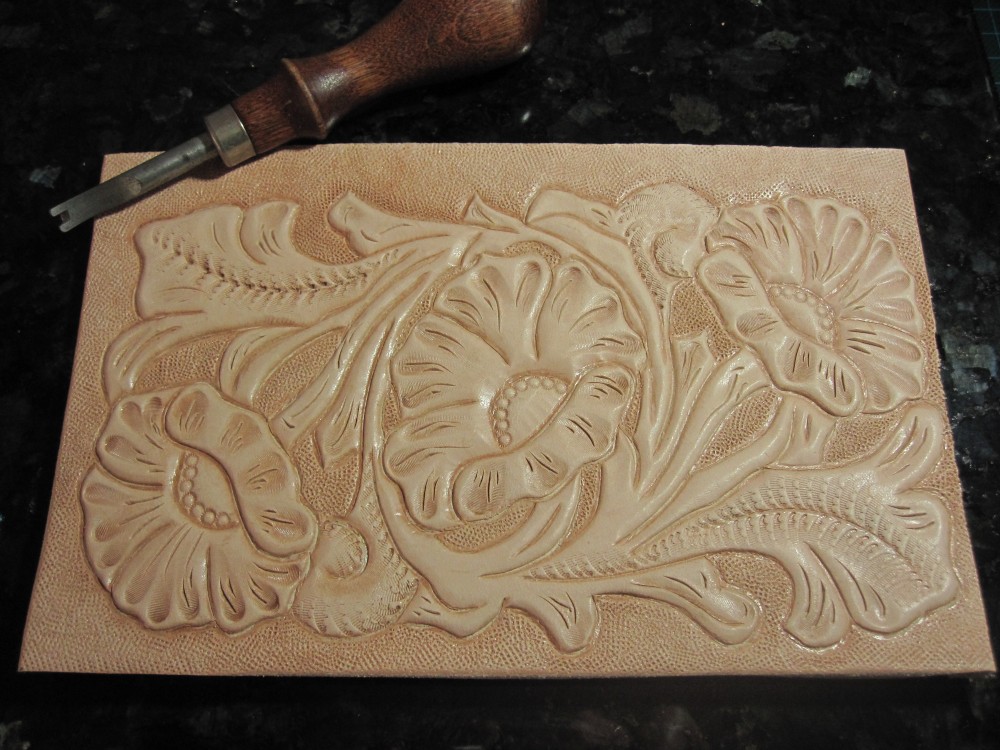

This is my 4th. project. I started leathercrafting just three weeks ago so this is only another excercise to improve my tooling technique. First pic has been taken after carving, beveling and backgrounding. No finish or oil has been applied yet to the veg tan.

Very Nice!! I'm just beginning, too...I wish my first stuff looked that good!
That looks great! I am just starting out, too. Yours looks so clean and sharp!
For someone tooling for only three weeks, you are doing one helluva job. The main thing I would point out to you at this point is to work on your beveling, making it smoother, and not leaving "tracks. While beveling, maintain the roundness of your curves, ie the petals of your flowers so they don't have somewhat pointy tops. The rest will come with time and practice, and at the rate you are progressing, I can't imagine what you will be doing in a year. Something that may be of benefit for you is one of Al Stohlman's books on proper tool use. He was a master at explaining things in a manner that made sense. Good job,
Terry
Wow... I went to a class for basic tooling two weeks ago. I need to find some floral patters with common items in them to work on. From there I could work on the craft and lead into the design of my own stuff. I dont have a real big need to floral but it would be nice for gun holsters and such..... Keep working on it. Chris at Tandy say the second design would 100% better than the first, and the third 100% better than the 2nd...etc. I have done three pieces so far and they are getting better....

Here are a couple of thoughts I have.
I'm wondering if you had your work piece properly cased when you started tooling. Getting something cased properly is more art than science and is very important in getting good tooling results. It needs to start out really wet. Veg tan will turn a pretty dark brown. Let it set open air for awhile until all the surface moisture has soaked in or evaporated. Then put it in a plastic bag and then you can let it remain at room temperature or put it in the refridgerator for awhile. When you take the piece out of the plastic bag let it continue to dry out until it starts to return to it's normal color. It will be/needs to be cool to the touch. When the color of the piece is between the dark brown when it was wet and the pale color when you started you can begin swivel cutting and tooling. When veg tan is properly cased your tools (bevelers, pear shaders/thumb prints,) should leave a darker burnished imprint when you strike them.
The other thing is to make sure your swivel knife is sharp, all of the marks left from honing on the cutting edge need to be polished and stropped out. The cutting edge should be a bright mirror finish with no visible scratches. When using your swivel knife strop REALLY often, it will make a whole lot of difference in how your blade cuts through the leather. If it is dragging it needs to be stropped more or sharpened.
A critical point that separates floral carving from great floral carving are the finishing cuts, decorative cuts, or dress cuts. They need to start with a fine point as the cutting tip/edge of your blade enters the leather. Then the cut needs to immediately start to taper to a fine point. Learning how to make proper finishing or decorative cuts will make all the difference in the world in how your finished work looks. Look at example of excellent carving on this site and see how the finishing cuts look and learn how to copy those. Practice as much as you can with your swivel knife to perfect this technique.
Good luck, keep up the good work and have fun!
Bill
