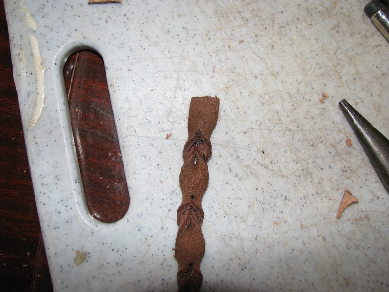

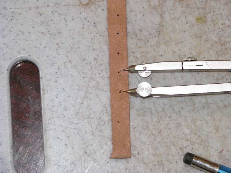

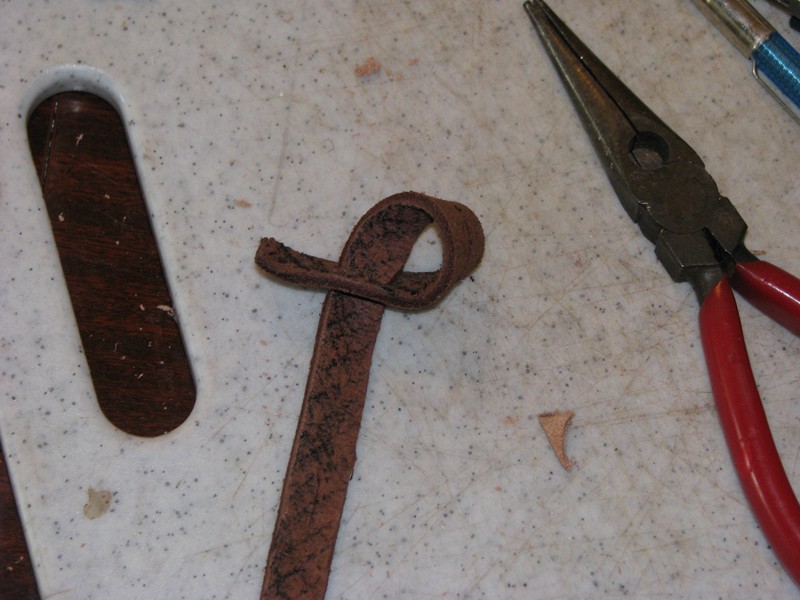

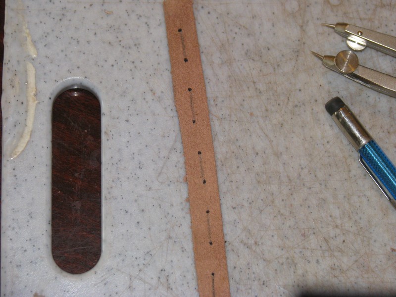

Contributing Member TwinOaks Posted May 25, 2008 Contributing Member Report Posted May 25, 2008 (edited) Maybe Luke or Bruce will correct me on this, but here goes: I think the original idea of the "night-latch" wasn't so much as a 'grap-in-case-of-emergency' strap. It was for the cowboy who had overnight sentry duty on the herd. The original idea was kinda like a retaining strap incase the cowhand fell asleep at the reins. For a nice pretty little design, here's an idea: take a strap of whatever width you like, and dye one side of it. Now, measure the width of the strap and write it down; We'll call this X. A set of dividers is great for this next part, but I have used a ruler. Measure X from the end of the strap (maybe a little more depending on the way you mean to attach it), and mark a spot. Staying centered on the strap, mark X's for the length you want the night latch. Connect every other set of dots with a knife, so that the slit looks like a perforated line down the center of the strap. ( - - - - - -) I'd like to point out here, that you can play with the 'tightness' of the pseudobraid by varying the spacing between the slits. Width of the slit can be played with a little, but needs to stay close to the strap width until you get the technique down. Leave a pretty good running end on it, and cut a point at the tip. Now, (hoping you haven't used Eco- dyes) wet the whole strap. You'll want it pretty wet for this, as you'll really be stressing the leather. Now, take the running end (point) and pass it through the first slit, being careful not to twist it. Just keep pulling until the strap rolls in on itself. Repeat down the strap through each consecutive slit. Let dry and apply finish, then attach with aforementioned break away. I'll post a pic when I can find it. Mike Edited May 25, 2008 by TwinOaks Quote
Members AndersHeintz Posted May 25, 2008 Members Report Posted May 25, 2008 I think you are right on the money Mike about the Night Latch. I really can't see it very useful at all as a bucking strap, that would probably be the worst thing to grab if your horse starts pitching, kind of like the saddle horn, will get you into more trouble then you had to start off with. Quote
Contributing Member TwinOaks Posted May 25, 2008 Contributing Member Report Posted May 25, 2008 (edited) To be clear, this is only one design, which is easy to make, and looks pretty good- you could always take the 8 strand flat braid approach.... [attachment 11644:lwpics6.JPG] As stated in the prev. post, if you wanted the 'braid' closer together, you might try the spacing between slits at 1/2 X. On good leather, rather than a split, the side roll will show the color of the back of the leather, so you can color the back and have , light on dark or color the front and dark on light. Mike Thanks to the OP on this type of strap, for introducing it. I couldn't find the thread or the pics, so I had to improvise. Edited May 25, 2008 by TwinOaks Quote
